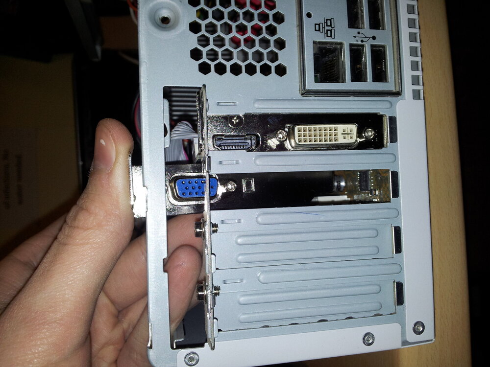

Does anyone know where I can get hold of these cables from with the VGA on the end for graphics cards as pointed in the picture.
As the text states, we're having trouble fitting these cards into low profile machines, as the low profile bracket seperates the VGA from the card so it sits in it's own expansion slot, but the cable the VGA is attached toi isn't long enough for the VGA to reach the slot (if that makes sense).

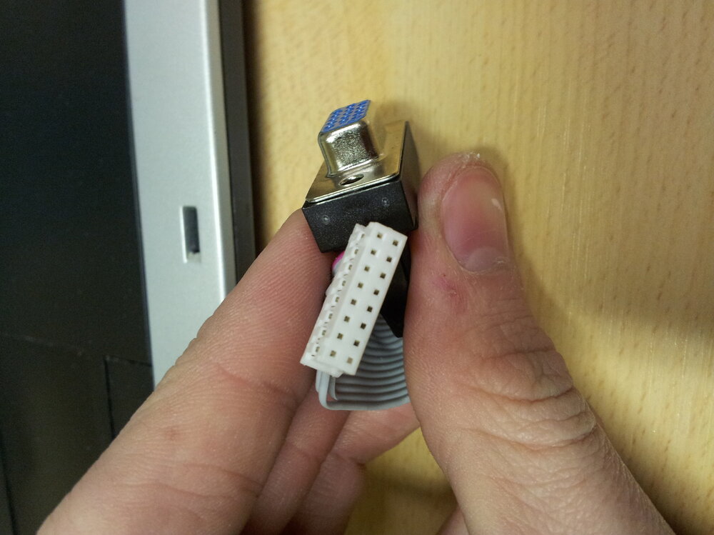

Here are some more picture to try and explain what I mean:

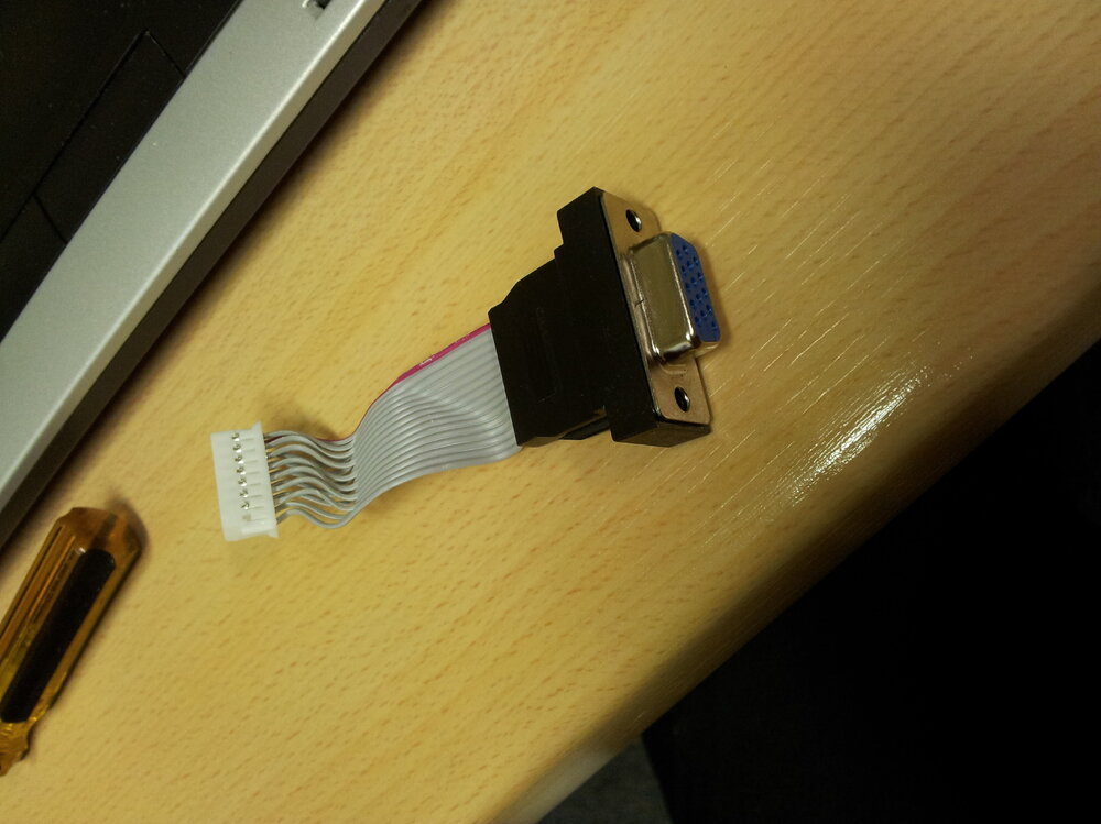

This is what we're trying to get hold of - only longer (if possible)
The side that connects to the graphics card has room for 16 pins,
but only uses 15 like the VGA.
And just a few photos to show it won't fit:

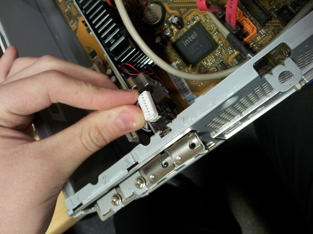

As you can see, if I put the VGA plate in place first, then
try connecting the cable to the card, it's not far off:
The computer we have is a Fujitsu Esprimo E3510, and the cards we've used so
far are a Club 3D GForce GT610 and an Asus GEForce GT610 - essentially the same
but we were hoping one would fit better than the other (it didn't).
