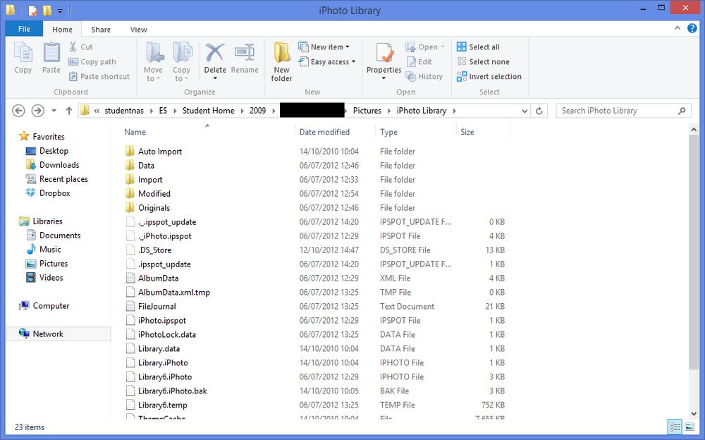

I've had a look at where iPhoto stores files and attached a screen shot of a student's folder. It appears that it does indeed create some files and folders in the user's documents, they look like references to where they're stored, a bit like what iTunes makes on a Windows computer. However, touch wood, even though they're stored on a server, we've never had a student complain about lost or corrupted work, and I've been responsible for the Macs for just over a year now. From what I've gathered off the art teacher, the students use iPhoto to manage their pictures, then do editing and what have you with Photoshop.
I am really curious about this Iphoto thing now. When I try to open Iphoto on a mac that has been logged into our domain , I get the error : The library could not be opened because the file system of the library is unsupported. So Iphoto cannot be setup on an NTFS drive (i.e that being his windows user area). I wonder where your Iphoto stuff is being stored. On the Mac Mini?
I found this post from someone else.....
iPhoto does not support working with a library over network protocols e.g. CIFS, AFP. This is as true for iPhoto '09 as it is for iPhoto '11. Apple probably added a check into iPhoto '11 due to receiving complaints from users who found iPhoto didn't work over network protocols.
It's looking like if I want to use Iphoto and a windows domain I need to purchase a mac mini server. Blimmin' Iphoto!
iPhoto will work with AFP shared home folders, that is what you will be using if you buy a Mac Mini for network storage. The easiest solution is to use local home folders, but still authenticate to Active Directory. This will only work if people always use the same computers though, and you need a way to backup the data.

I can't say for certain but I don't believe this is true. As already pointed out earlier in the thread, iPhoto (as it exists now) has a monolithic slab of a database that contains images. If one image is modified or changed the whole of the database is written across the network. This can cause major problems if multiple users with large iPhoto libraries are doing this regularly. This was not the case in earlier versions.

iPhoto can be made to work in a network environment by simply redirecting the Pictures folder to a temporary location (a cache) on the local drive for a user login session only. The cache is then flushed on successful log out. I've a feeling you may be able to achieve this using a GPO redirection policy. The share containing user homes exists on the DC after all. It's worth a try don't you think?

iPhoto will only run from a HFS+ formatted drive/share. This is why you receive the "The library could not be opened because the file system of the library is unsupported" message. We have no problems with it running over a network.
