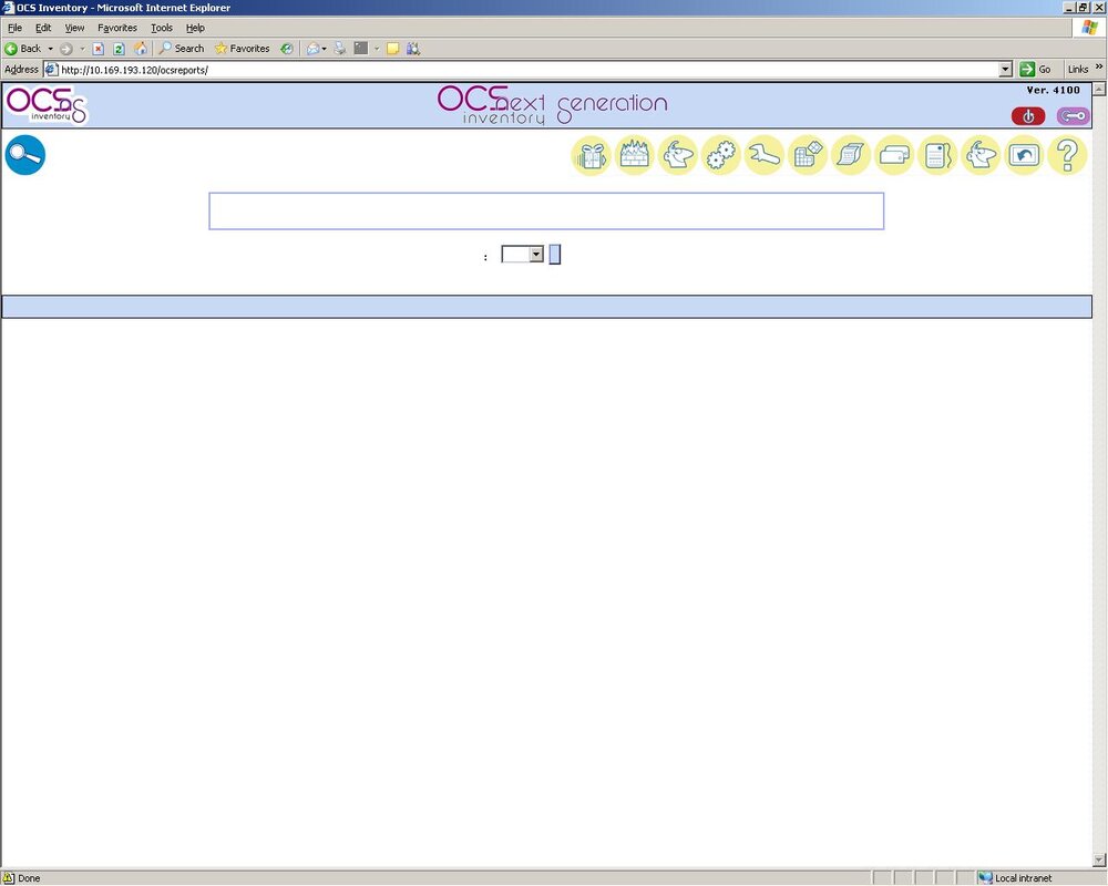

sqdge Posted June 15, 2007 Report Posted June 15, 2007 I am trying to install OCS Inventory on my system. I have the installation working fine, and I'm able to access the OCS Reports page from another computers. However, there appears to be lots missing from the page, plus it says "Done, but with errors on the page" at the bottom. I wondered if it was a stylesheet issue, but the conf file is pointing to the correct server's IP address - so it should work fine. I am having a similar problem with GLPI. Any ideas?
Ric_ Posted June 15, 2007 Report Posted June 15, 2007 I have a problem with OCS sometimes if I don´t select English as the language.
plexer Posted June 15, 2007 Report Posted June 15, 2007 If I don't select english on the login screen I can't see the boxes to login with. Ben
sqdge Posted June 15, 2007 Author Report Posted June 15, 2007 If I don't select english on the login screen I can't see the boxes to login with. BenThanks - that was the biscuit.
