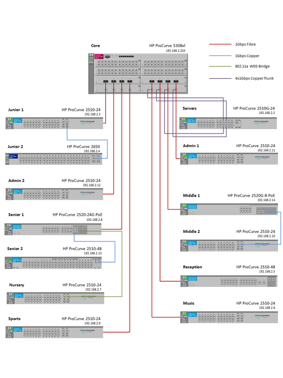

A topology if you are able to provide one to us would also help diagnose what the issue might be.

OK, the multicast server remained off yesterday as I was doing a lab build all day, but there still seem to be no recurrences of the problem. I plan to fire it back up tomorrow when no-one else is in to reproduce the issue and do some more troubleshooting.
I know the details of the multicast IPTV server extremely well as it's a personal project. It has been running pretty much 24/7 for 2 years with no issues, so it's a little odd that it's suddenly causing problems now. IGMP is configured on all switches on the VLANs which carry the IPTV: with ~100Mbps of multicast traffic being pumped out by the IPTV, it's very obvious from the traffic graphs if you miss a switch (as I have once in the past). It broadcasts SAP on the normal 224.2.127.254 address, and the ITPV channels are on the following addresses:

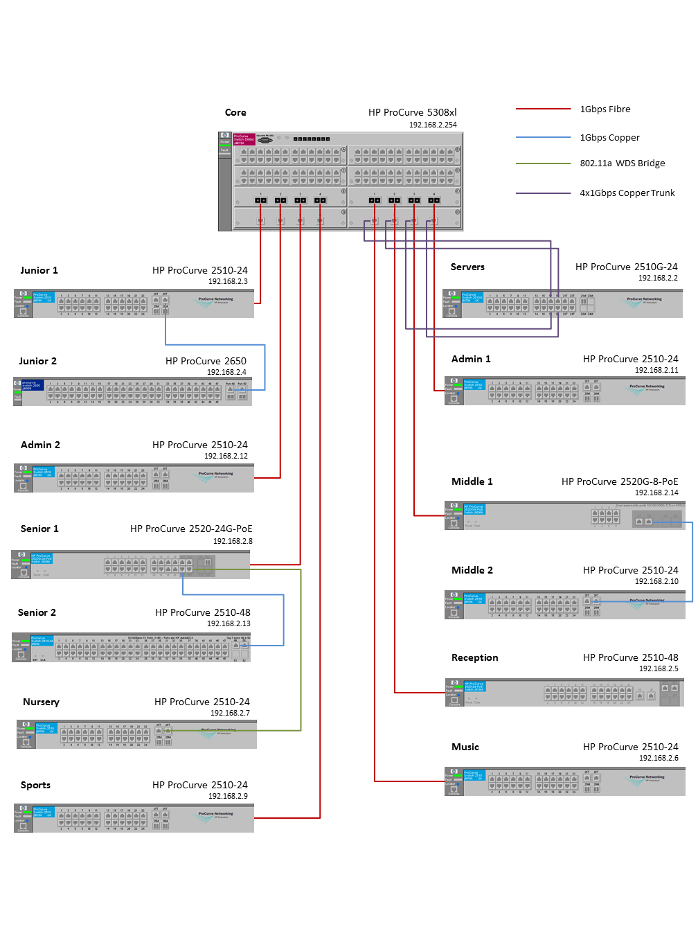

Unless I've missed something, the IPTV streams are all in the administratively scoped multicast address space, and there are no other multicast servers on the network (aside from the WDS server, but I never use the multicast features).
I've attached a switch topology graphic. The only time I have more than one connection between any two switches is between the core and the switch immediately below it in the rack for my servers. The 4 links are trunked, and there are no reported errors with that so it is acting as a single 4Gbps link.
At this point I'm beginning to wonder if this switch just can't hack that much IGMP/multicast and the routing at the same time, regardless of whether the traffic is to-standard or not. The CPU and memory aren't getting much above 50%, but it wouldn't be the first problem I've had with sub-par performance from HP kit.
Edited by AngryTechnician
