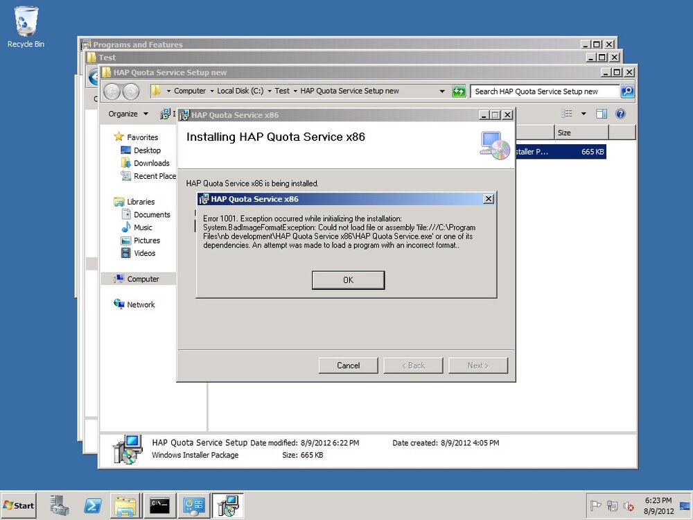

mobybrick Posted August 5, 2012 Report Posted August 5, 2012 Hi Nick, Got around to testing this as soon as possible, just now. The zip link you sent won't install - during install it says error 1001 Exception occurred while initialiazing the installation: System.BadImageFormatException. Do I need an x64 version, or can you do me another build & I'll try to test asap... Many thanks, Moby

nickbro Posted August 5, 2012 Report Posted August 5, 2012 x86 is for Windows Server 2003 or where the Drive Quota System is used. The x64 should be the one to use on most new servers. The Service Meta Data is on port 8011
mobybrick Posted August 5, 2012 Report Posted August 5, 2012 The one attached to this thread won't install and both versions on the skydrive are x86, despite the name.
nickbro Posted August 5, 2012 Report Posted August 5, 2012 O, how odd, they shouldn't be, if they are installing that's a start

mobybrick Posted August 9, 2012 Report Posted August 9, 2012 Hi Nick, Latest build still calls itself x86 version and still won't install with same message as before Moby
nickbro Posted August 9, 2012 Report Posted August 9, 2012 Hmm, I can't see anything wrong with the installer, I've rebuilt it, and readded the references. HAP.Data.Quota should be 32bit, but the actual service should be 64bit.
mobybrick Posted August 9, 2012 Report Posted August 9, 2012 There's something up with the installer I'm afraid. Even trying to install on a fresh new machine fails. Because the installer fails (and deletes any files it tried to copy) with the bad image format error, I can't test anything Event viewer shows: The description for Event ID 11001 from source MsiInstaller cannot be found. Either the component that raises this event is not installed on your local computer or the installation is corrupted. You can install or repair the component on the local computer. If the event originated on another computer, the display information had to be saved with the event. The following information was included with the event: Product: HAP Quota Service x86 -- Error 1001. Error 1001. Exception occurred while initializing the installation: System.BadImageFormatException: Could not load file or assembly 'file:///C:\Program Files\nb development\HAP Quota Service x86\HAP Quota Service.exe' or one of its dependencies. An attempt was made to load a program with an incorrect format.. (NULL) (NULL) (NULL) (NULL) (NULL) the message resource is present but the message is not found in the string/message table Do you need x64 versions of the dependancy dlls, or has there been any other change? M
nickbro Posted August 9, 2012 Report Posted August 9, 2012 Try this again, I've removed the custom action that was being used to register the service. You will need to browse to %programfiles%\nb development\HAP Quota Service and run Register.vbs. You will need to run Remove.vbs before you uninstall. I'm looking into why this is happening
