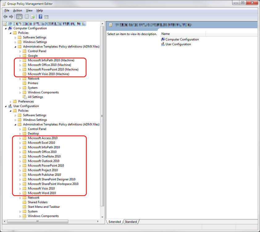

I'd also recommend you download the Office 2010 Resource Kit (ORK Tools). This allows you to control Office 2010, just as you would Windows 7.
Extract and then copy the ADMX files into C:\Windows\PolicyDefinitions then open Group Policy Management to find all Office 2010 policies ready to 'tweak'.

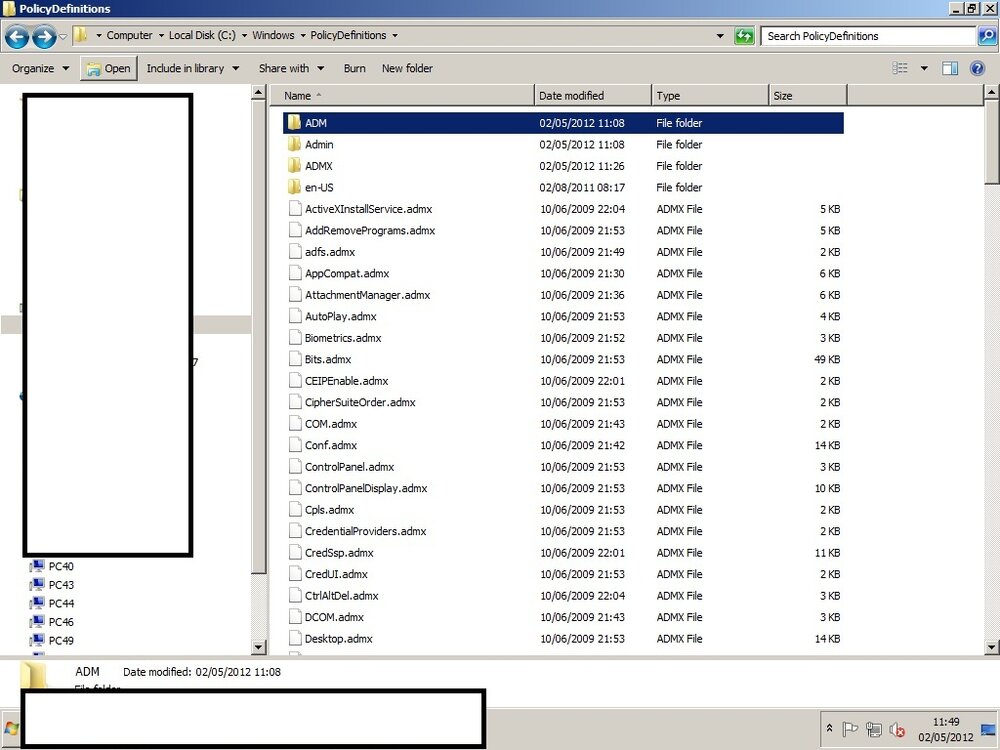

I have downloaded that file the 32bit and extracted into the folder you said. fired up group policy manger created a new grouppolicy but where are the settings?
right there not in that section here is a screen of the foldergp.jpg if i move the files from the ADMX folder up a level then when i open up gP manager i ger a parse error on them files?
They shouldn't be in the ADMX folder, they should be in the main folder, with the accompanying ADML files in the en-US folder.
If all those files are in the correct place and you are still getting parse errors, then that suggests there is something wrong with them. Try downloading them again.
