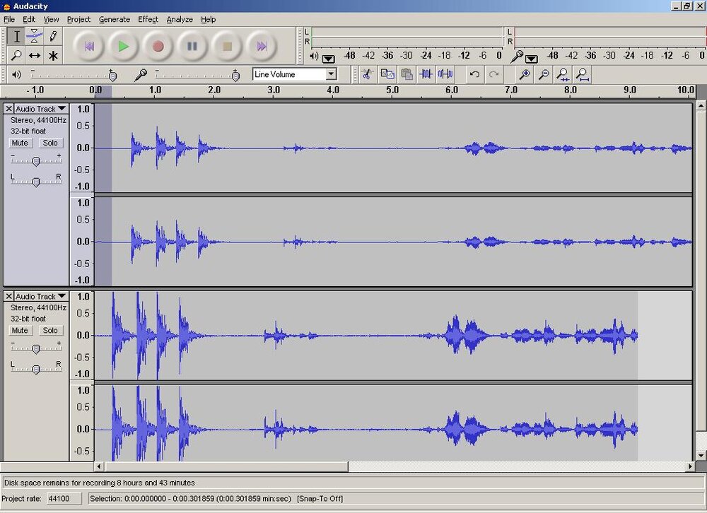

I'm going to see if I can use audacity to do a comparative test between devices.
