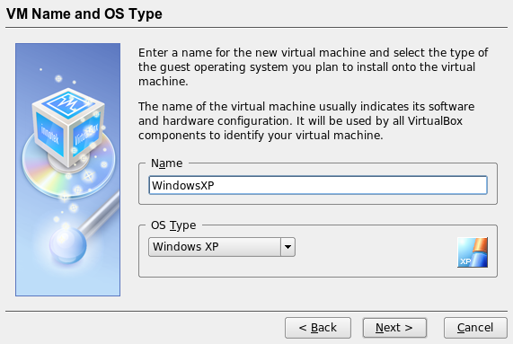

I am trying to set up a virtual RM CC4 machine on an apple mac in VirtualBox. This is my first few steps into the virtualised world. I have tried making an XP VM and then pxe booting it but its having none of it.

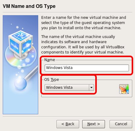

When I build a CC4 client in a virtual machines I had to set the guest OS type as Vista 32bit. I understand that this is because the WinPE bit of the build requires the VistaPE drivers.

When you are configuring the vm properties, do you set the OS type as Windows Vista 32bit?
Which operating system is the guest VM going to be running in VirtualBox? :confused:
The virtual NIC used by VirtualBox for both Vista and 7 is an Intel Pro/1000 MT so it doesn't matter that much which OS type you select. However, I would select the correct one for the OS you are going to using in the VM.

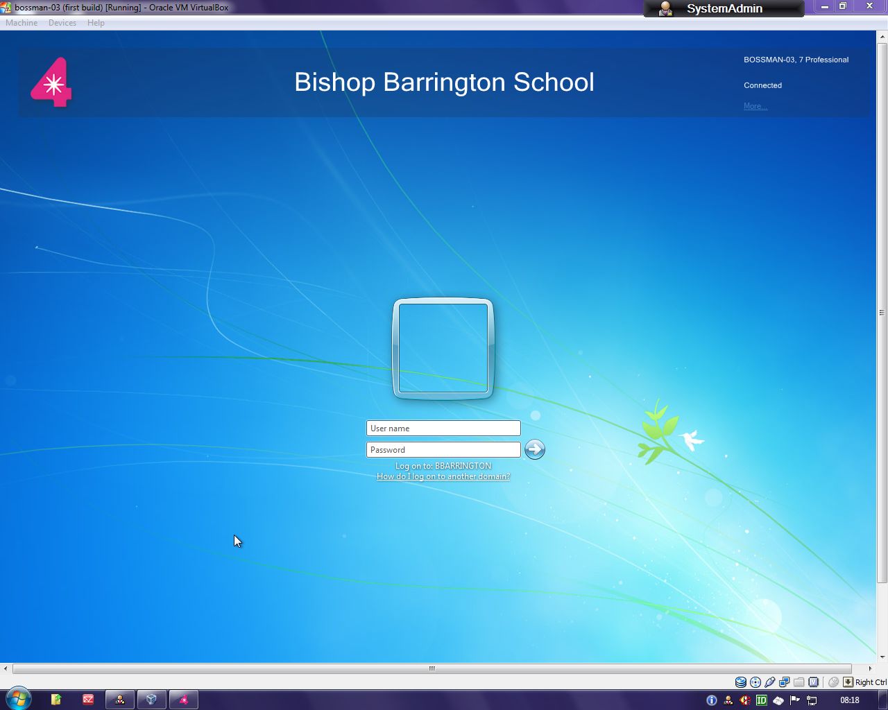

I set the OS as it states and this would be windows 7 also increased the memory to 2Gb and increased the CPU to 2, network settings as bridged which should pick up the host machines network card and Set the IDE controller in the storage settings to point to our default RM build iso and Bob's your uncle.
