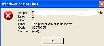

I've tried using pushprinterconnections.exe with 2003 R2 Printer console but the results are far from consistent (sometimes it took two reboots to add all printers, sometimes it just didn't add them), so I thought I'd switch to a simple .vbs script: Add a Printer Connection
This gives a similar experience. If I have two GPOs each with a single printer, it takes two logins for them both to be added.
Any ideas?
The XP machines don't have CSE installed yet, so I can't use GPP.
Ignore the attached image, I seem to have resolved that.
