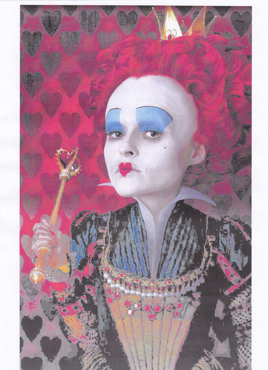

For some reason our offices HP 3600n printer today decided to start printing abit strange, I have ran all the diagnostics on the printer and ran a ful l reconfiguration but the problem still continues. All toners are pretty much full having only been replaced a few weeks ago.
Here is an example, the image sent and the results scanned back in.

looks like its missing black to me.
is the black toner actually getting to the developer in a good amount, heard of issues where a pipe/feed can become blocked on some lasers which reduces the amount of toner getting onto the page.

The problem is defintly missing black as you said but it appears to be going to the developer fine on PQ tests and on just black such as text. Draft setting is not on.

Looks fine, I added some shapes in word with random colours and overlapping and no issue either. Seems to be on images when there aren't clear cut lines
We have had similar issues with 36/3800's. Where printing plain blocks of colour was no problem, they didn't seem to "mix" correctly. The quality tests also looked fine.
In the end we diagnosed that it was the toner that was the issue, it being damp or poor quality; replacing them fixed the issues.

Thanks for the tip, didnt have any spare black toners but "borrowed" one from the admin teams printer, they dont need to print images :p
