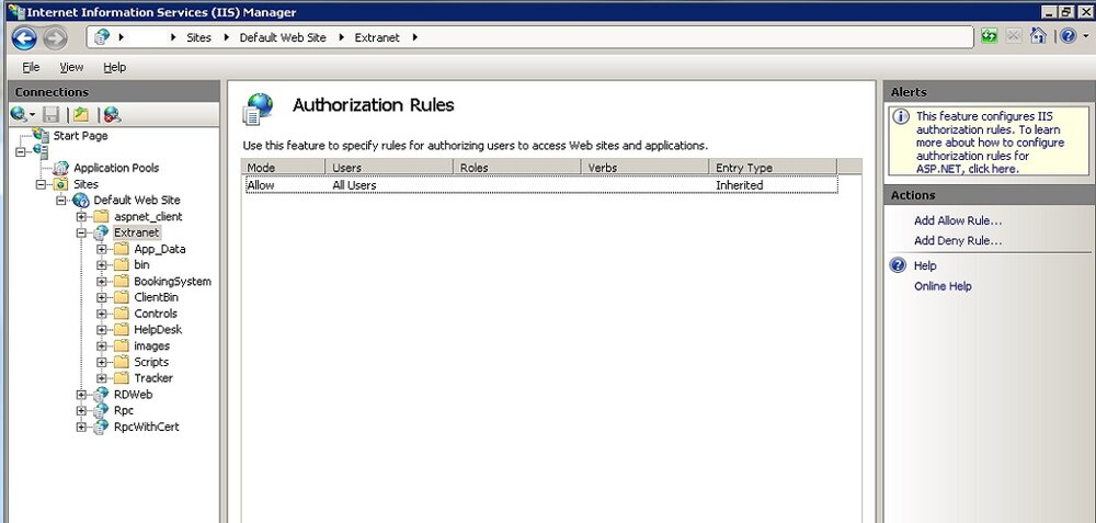

I had a similar problem, although I cant recall my error msg, I know it was similar!...
Have a look in IIS...
Go to Default Web Site > Open Extranet and click on Authorization Rules....
In mine in a fresh setup, there was a few deny rules, which kept throwing me out....I deleted the deny rules and gave All Users - Allow
Not sure if it'll work for you...but just incase! :D
Mart
Edited by Netwacky87
Added Screenshot :)
Ah, it could be that it requires a group called xxx Easylink. Change that to authenticated users or something like that
