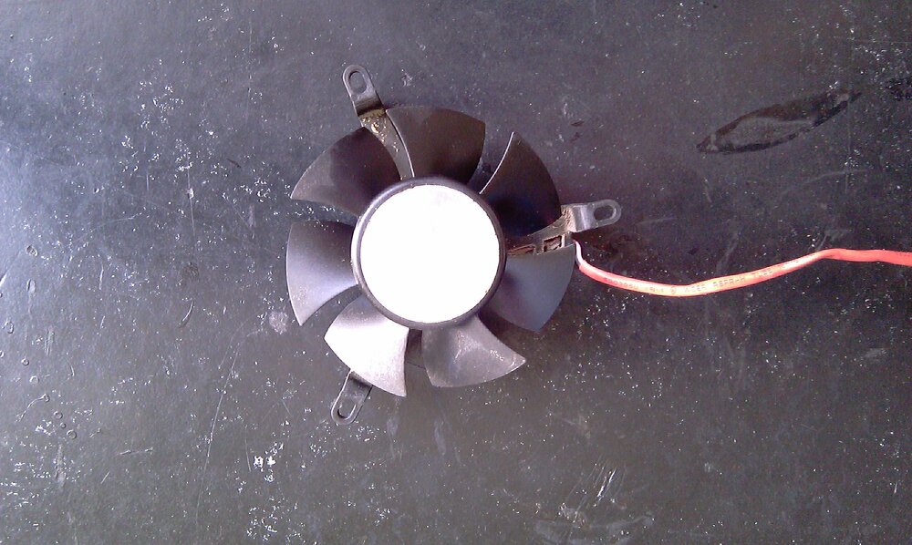

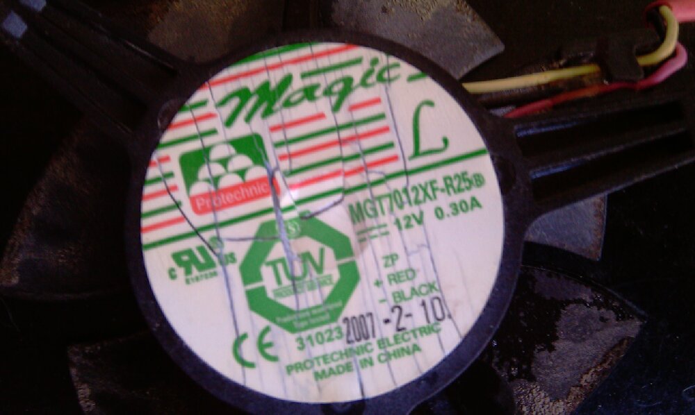

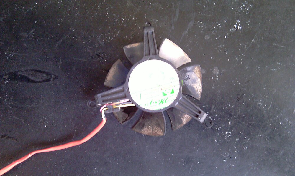

Sorry to bring up an old thread... A unifi 35 came in from a local school free of charge so we took up the offer.
The top most forward fan was making a noise. I took it apart and cleaned it up with compressed air. This only changed the noise the fan was making. So took apart again and used some wd40. The fan is now quiet enough to use but not silent.
