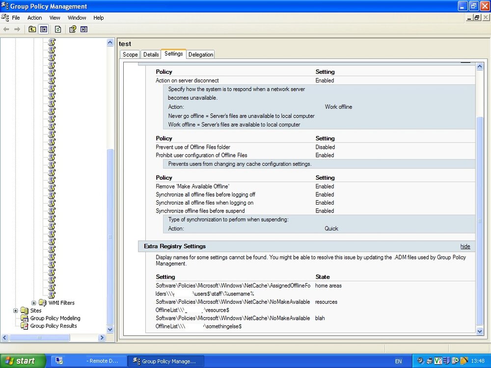

out of curiosity how do you limit what they can sync as i only want their user area synced
Just need to set the disable user configuration of offline files and also hide the make avalible offline bits in GPO then they will only be able to get the administrativly applied stuff.
