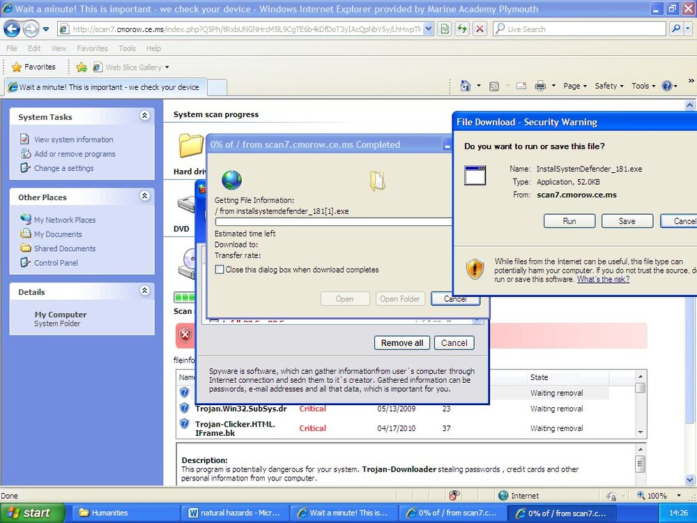

They were definitely the same viruses, one had 14 others as well as the fake AV type one but were at different stages of infection. One was reported immediately and the other had several days of runtime on a home network.

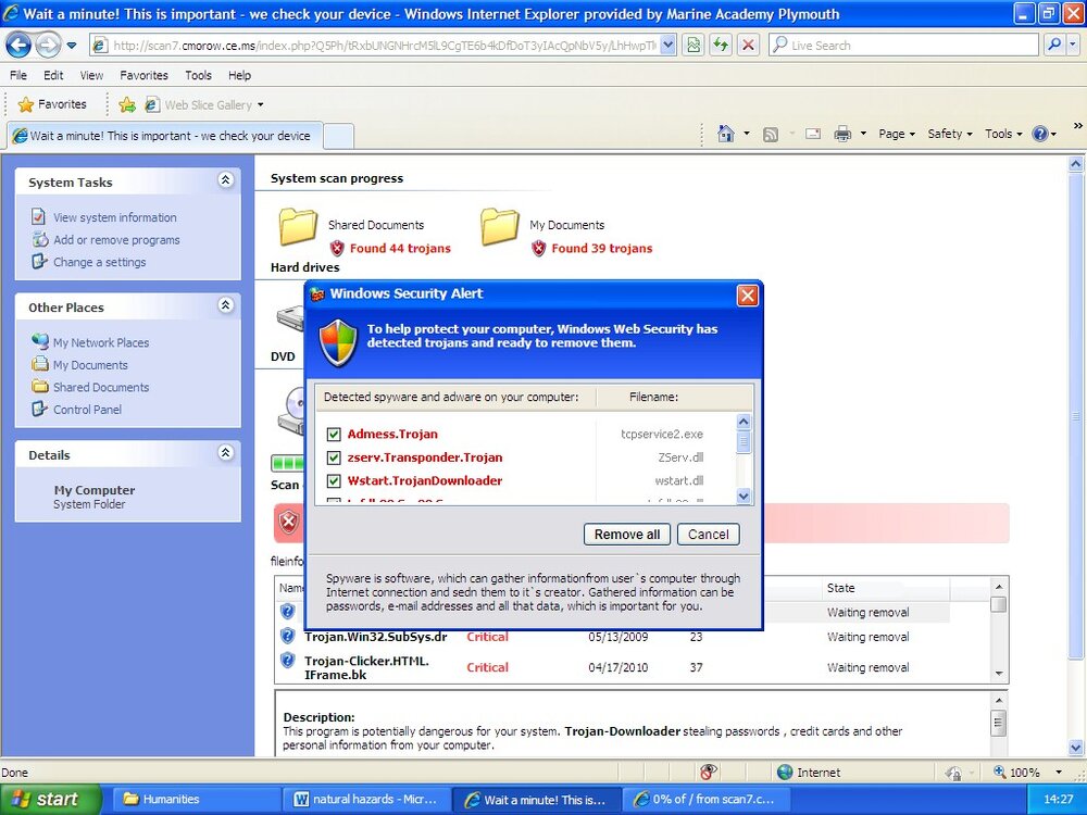

We've had at least 7 infections (personal computers and 2 on-site computers) in the last week. All have come through a Java exploit (.jar files stored in the temp files) and deployed the System Tool 2011 fake agent. A full scan using Malwarebytes has cleared them all (except for one which had it's boot-up corrupted). All have mentioned Hotmail. I know several sites are affected by this, but we've taken action by blocking Hotmail as it's heavily used and don't want any more infections until things calm down. Even though this ad servers have been reported to be cleared, it's still happening.

The code would appear to inject a "dropper" trojan : not dangerous itself but rather like Conficker was rumoured to be, just a gateway for other nasties to enter the system. Hence why there appears to be many different types of the same infection, once the dropper is there more nasties can work their way in such as the aforementioned rootkits. Had one yesterday that stopped anything remotely useful being run. My old man's work PC actually rebooted into a "fake safe mode" after it looked like a proper MBR based infection found it's way in off the back of this dropper. Needless to say I didn't waste time in suggesting the use of a liveCD to backup then kill off the HDD!
This is the symptoms I had, programmes being intercepted before being able to run. From a novice in the world of viruses etc, I must say I was somewhat impressed by what this was doing, not taking away the anger and frustration it causes. I guess probably quite easy to do, but I did tip the hat to the creators!!! :D
Had my first of the new varient yesterday, teachers laptop and then had an LSA say she had it on her PC at home so just printed off the instructions on the Malwarebytes site for getting rid of it and let her have them. Can see these not being the first I will have to deal with! Had a similar one a couple of months ago but this seems to have hit big time in comparisson.
