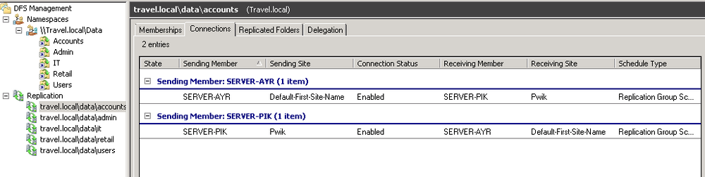

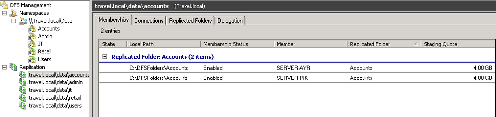

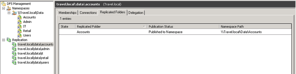

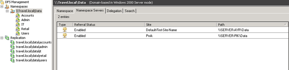

  22. Hi, I have multiple Windows 2008 R2 and 2012 Servers connected across WAN links that are members of a DFS-R group. Recently, one of my 2012 Servers has stopped replicating files with the other members. Both old and new files are not replicated to and from when created on either side. I've checked the DFS Replication event log on the affected server and found the following event: The affected server has 5 replicated folders under 1 namespace, all of which replication isn't working for. Can someone please advice how I should proceed as I am quite new to DFS and worried in case I mess things up and cause loss of data. Thanks Fraser
  23. Hi, I’m in the process of setting up a new server at a new remote office and I want to create a couple of Distributed File Shares across the two servers with folder replication between two different WAN sites. I think I’ve configured everything right however there is definitely something fishy going on that I can’t seem to workout. I have some GPO’s that map network drives to the DFS folders and they are failing. Event viewer says: '0x80070035 The network path was not found. Once I have logged in, I can successfully open \\travel.local\data\Admin, yet the GPO is mapping the drive to the exact same path. (The DFSRoot is Data). If I browse to the server by \\IP_Address or \\Travel.local and double click on Data share, it opens as normal. Other GPO’s that map to non DFS shares map just fine. I’ve attached some screenshots of my configuration and some command prompt outputs. Any help would be much appreciated. There’s very little data being replicated and as this is a new setup, users do not have access to the DFS shares yet so I can recreate if need be. Fraser Server-AYR_IPCONFIG.txt Server-PIK_IPCONFIG.txt
