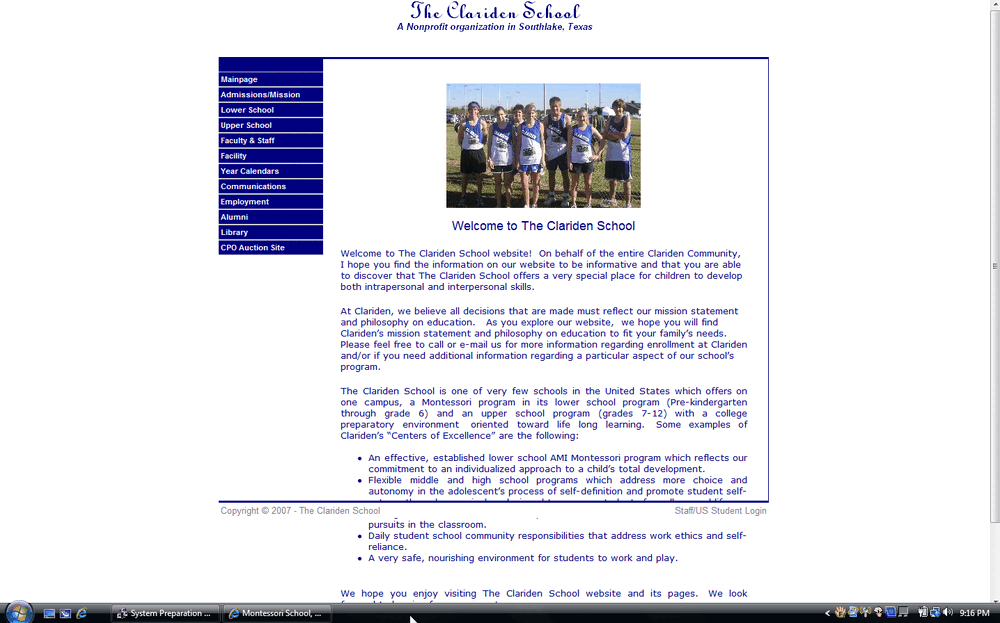

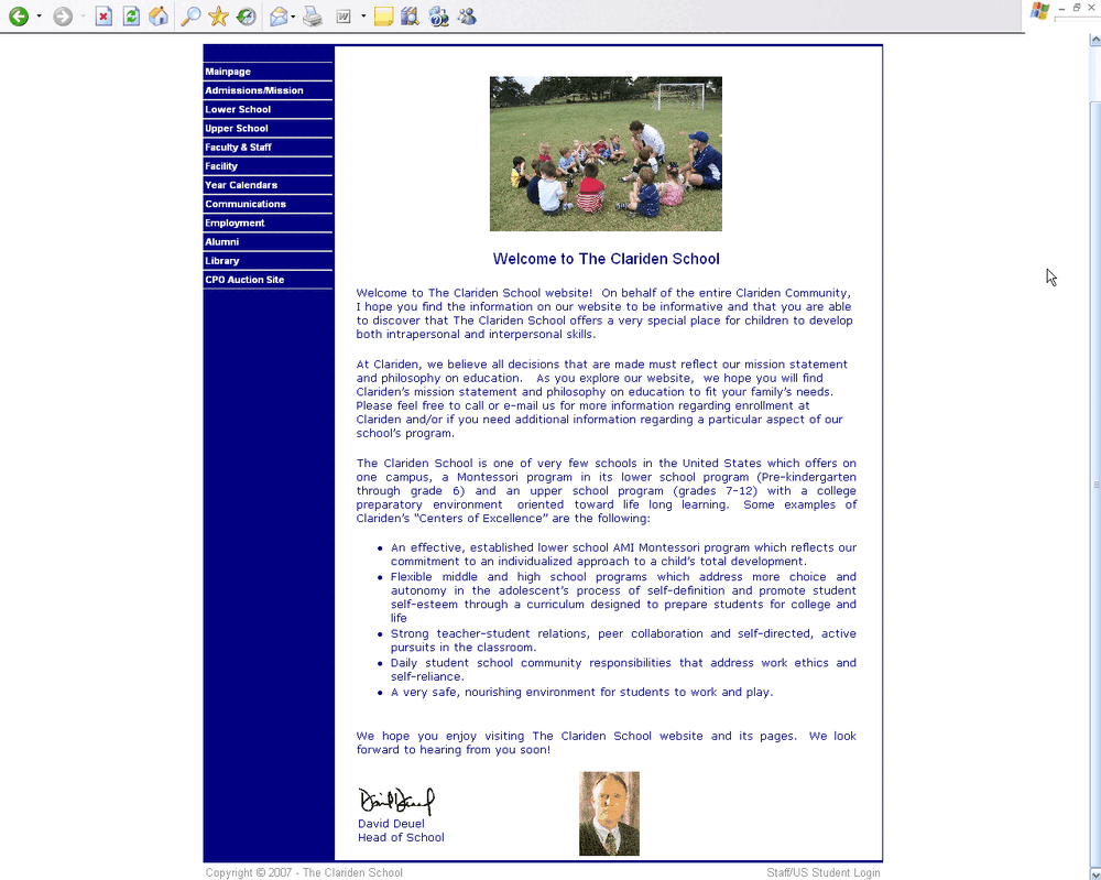

netadmin Posted February 25, 2007 Author Report Posted February 25, 2007 I tried taking out the height tag from #content, no luck I am posting screenshots from IE6 and IE7. Sorry they are different resolutions (the only computer I have IE7 installed on is a new Vista laptop we just got, and it is a lot different resolution from my desktop computer).
MkII Posted February 25, 2007 Report Posted February 25, 2007 It fixes it for me in firefox and IE7 claridentech. Attached is the modified file.tcsweb2.htm
netadmin Posted February 25, 2007 Author Report Posted February 25, 2007 Thank you so much for your help, everyone (especially Mark). I uploaded the revised style tags and everything works perfect in both IE6 and 7 now! Thanks!

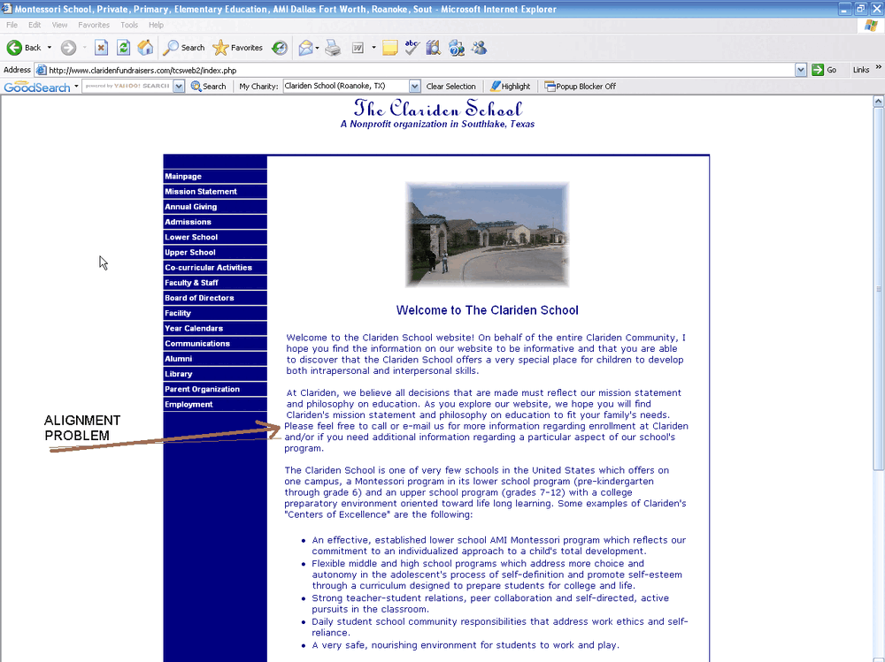

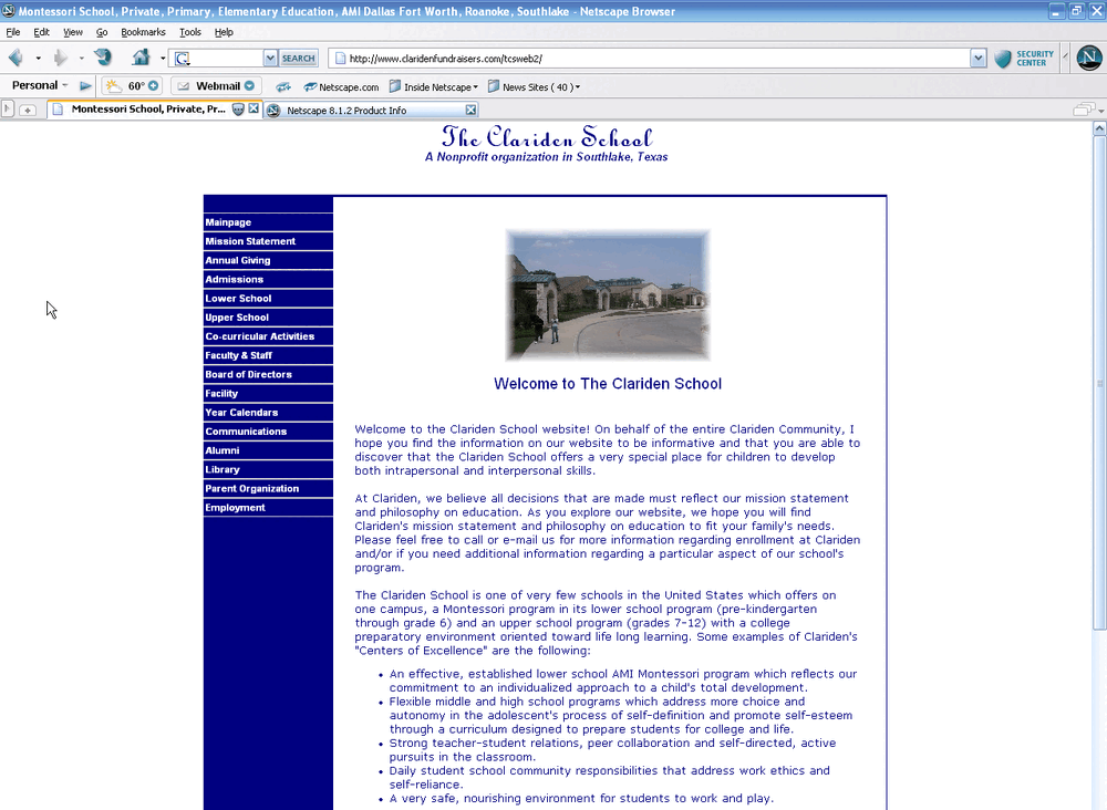

netadmin Posted March 10, 2007 Author Report Posted March 10, 2007 OK this is odd now. My page text displays perfectly in Netscape and Firefox, but the left margin in not lined up properly in IE6. This is just a normal space in a sentence, no special formatting used. Attached are two screenshots. If anyone has any ideas on this, I'd be very happy Luckily, I am starting to figure out how to fix CSS problems, but I am still a ways from really understanding CSS entirely.
webman Posted March 10, 2007 Report Posted March 10, 2007 That looks like the old 'IE6 Three Pixel Gap'.
netadmin Posted March 10, 2007 Author Report Posted March 10, 2007 Thanks, webman. I had not heard of that glitch. Everything's perfect [for the moment].
