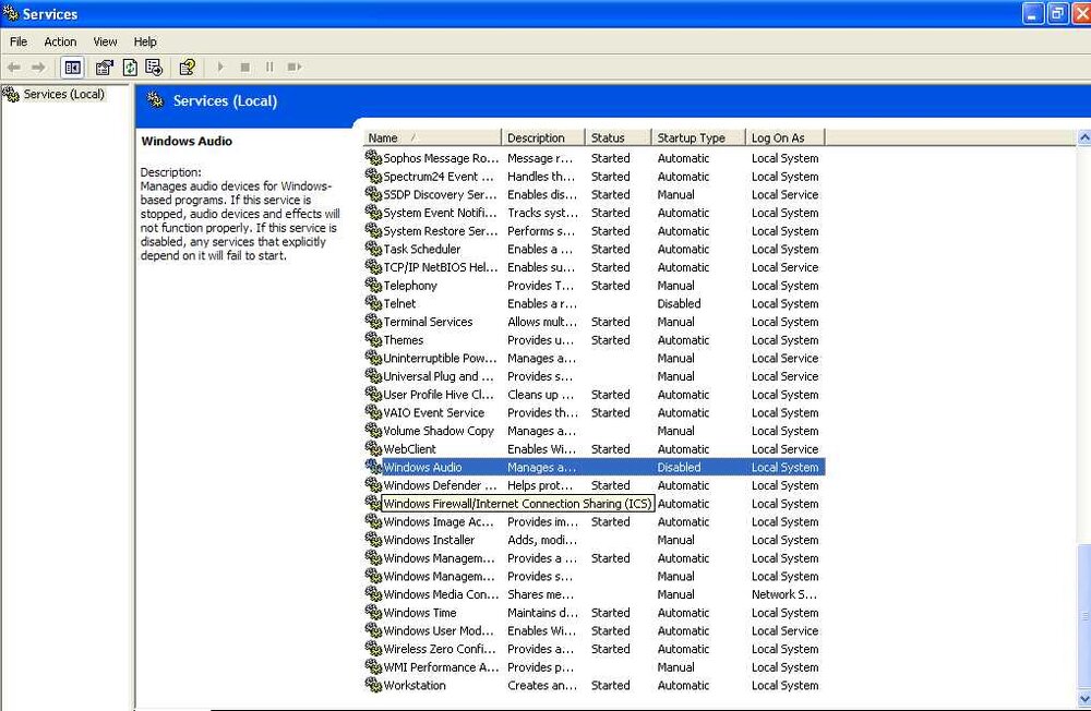

Thanks for all the help guys, but now I am back to where I started: Windows Audio disabled. Have a look at the attached pictures to see what I mean. Sure I can start the service and that may or may not give me sound depending upon how 'moody' my computer is today, but I shouldn't have to go in and start services manually (almost) every day.

go into the properties of that service and make sure its on automatic and that it automatically starts up and then reboot and see if it starts up by itself.
Hi gecko,
That is part of the problem. I set it to automatic, then after restart it is disabled again (on VERY rare occasions it is not disabled and sound does work. It never stays though and usually drops out before the end of the current logon session :? )

Another update: Sound is working pretty much all the time now, except for certain webpages with sound clips embedded. I can also get these to work if I start the Windows Audio Service which is always 'disabled' at startup, even though I keep setting it to 'automatic' Station changes since last post? About 10 Windows updates and Acrobat Reader 8. If it is one, or a combination, of these it/they took a while to kick in: It was about three days after all this [and several restarts] that I noticed that the sound had come back.
Now all I want to do is solve the Windows Audio Service start up problem.
