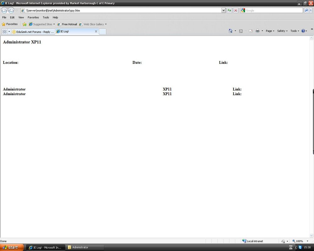

neon Posted February 10, 2010 Author Report Posted February 10, 2010 Cheers guys, seem to be getting somewhere the .htm file now appears and I can open it open however there is no websites in the links...?
mac_shinobi Posted February 10, 2010 Report Posted February 10, 2010 (edited) Cheers guys, seem to be getting somewhere the .htm file now appears and I can open it open however there is no websites in the links...? might be wrong but looks like you commented out your write line command 'oTextStream.WriteLine ' +----------------------------------------------------------------------------+ ' | Find Links within Index.dat | ' +----------------------------------------------------------------------------+ Sub FindLinks(strMatchPattern, strPhrase, file) Dim oRE, oMatches, oMatch, dt, start, sArray, timeStamp, url Set oRE = New RegExp oRE.Pattern = strMatchPattern oRE.Global = True oRE.IgnoreCase = False Set oMatches = oRE.Execute(strPhrase) For Each oMatch In oMatches start = Instr(oMatch.FirstIndex + 1,strPhrase,": ") If start <> 0 Then sArray = Split(Mid(strPhrase,start+2),"@") url=Left(sArray(1),InStr(sArray(1),chr(0))) dt=AsciiToHex(Mid(strPhrase,oMatch.FirstIndex+1+16,8)) timeStamp = cvtDate(dt(7)&dt(6)&dt(5)&dt(4),dt(3)&dt(2)&dt(1)&dt(0)) 'oTextStream.WriteLine "" & sArray(0) & " - " & timeStamp & " - " & ""&url&" - " & file & " - " & CStr(oMatch.FirstIndex + 1) & " " 'Visit User + Date + Visited URL if split(timestamp," ")(0) = FormatDateTime(date) then oTextStream.WriteLine ""&objNet.ComputerName&""+" "&timeStamp&""&" "&url&"" end if End If Next End Sub from the above section - not sure if thats where its getting its links from ? if you get it to work can you upload the working version here please ta Edited February 10, 2010 by mac_shinobi

neon Posted February 11, 2010 Author Report Posted February 11, 2010 mine still doesnt show any websites
