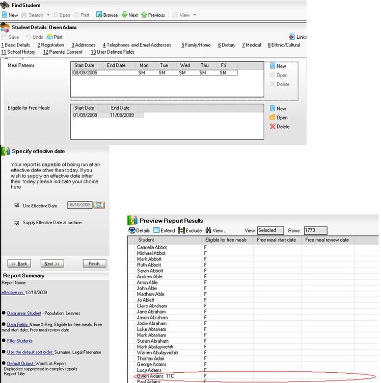

SteveB Posted October 12, 2009 Author Posted October 12, 2009 Well i've tried that, and the pupil is still showing as F for eligiable for school meals and the FSM eligiblity dates are still blank, even though if i browse to record i can see them. pic attached
superfletch Posted October 12, 2009 Posted October 12, 2009 Your "effective on" date (right hand side in your JPG) reads as 12/10/2009 where the childs record part of the JPG reads that the eligibility ceased sometime in September. The effective date doesn't seem to be set properly. 1
SteveB Posted October 12, 2009 Author Posted October 12, 2009 Your "effective on" date (right hand side in your JPG) reads as 12/10/2009 where the childs record part of the JPG reads that the eligibility ceased sometime in September. The effective date doesn't seem to be set properly. ohh bl**dy hell . . . .:bowl: I'll get me coat . . . . . . :sick::sick: Thanks
SteveB Posted October 12, 2009 Author Posted October 12, 2009 ahah! BUT! this will only work if i manage to pick a date within the elgibility range. This report is supposed to look back and show leavers with a listing of when they WERE eligable... If i run the report for 31/08/09 (1 day before eligibility) then i get no dates
