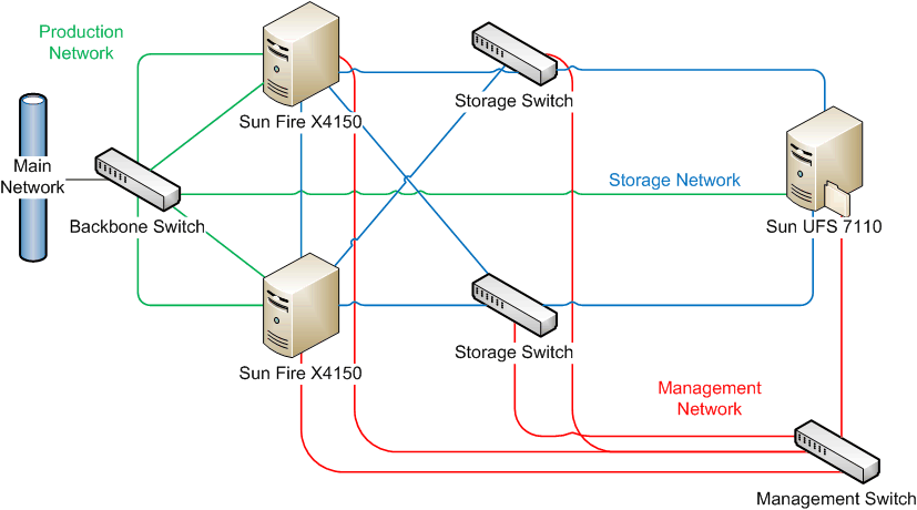

I've got mine set up like so:
In order to connect to NFS you have to have a NIC plugged into the storage switch and even on that switch, NFS-connected ports are on a separate vlan. The storage network uses a different IP range to make things easier under Xen - that's mainly for my sanity.
The green line going from the 7110 to the main switch is for ntp and sending reports back to Sun - there's no storage available on that interface.
Of course, that doesn't stop someone plugging the wrong cable into the storage switch, but it'd need to be a fairly long cable (by design - it's hard to screw it up) and I have a cluebat for that.
So is that card on the production network then, if so how do you stop people connecting over that card to your NFS share?
I have three cards on the 7110 on a seperate VLAN and IP range that I can connect to an NFS share over, the problem is that I also have one card on the production network for management and connecting to Sun like you but I can can't see a way to prevent an NFS connection on that card as well.
The card is on the production network in a 3 port vlan (dns server, itself, proxy server). My NFS shares are default deny and I filter* the switchports it connects to.
It would be great if we could say "disallow access to NFS on $interface01", but iirc you can't do that in OpenSolaris without firewalling on the box and that's suboptimal on a file storage device.
My problem is I need an accurate source of time for a) domain time b) storage & switches. Either needs to be accessible without the other. I could buy a GPS time source and use that, but I still would like the 7110 to have phone-home functionality.
*NFS, smb and iscsi traffic is blocked.
