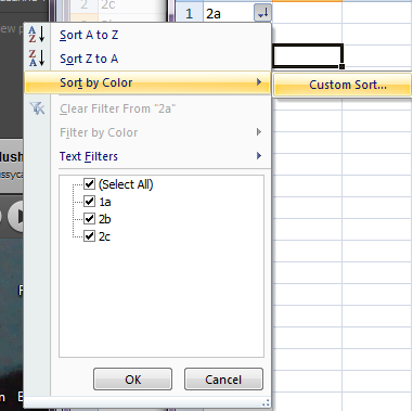

2007 includes the option to do a custom sort from the Auto Filter menu (although its hidden under the Sort By Colour menu). Another idea, what about defining a custom range in the sheet to save you selecting all the data each time?
