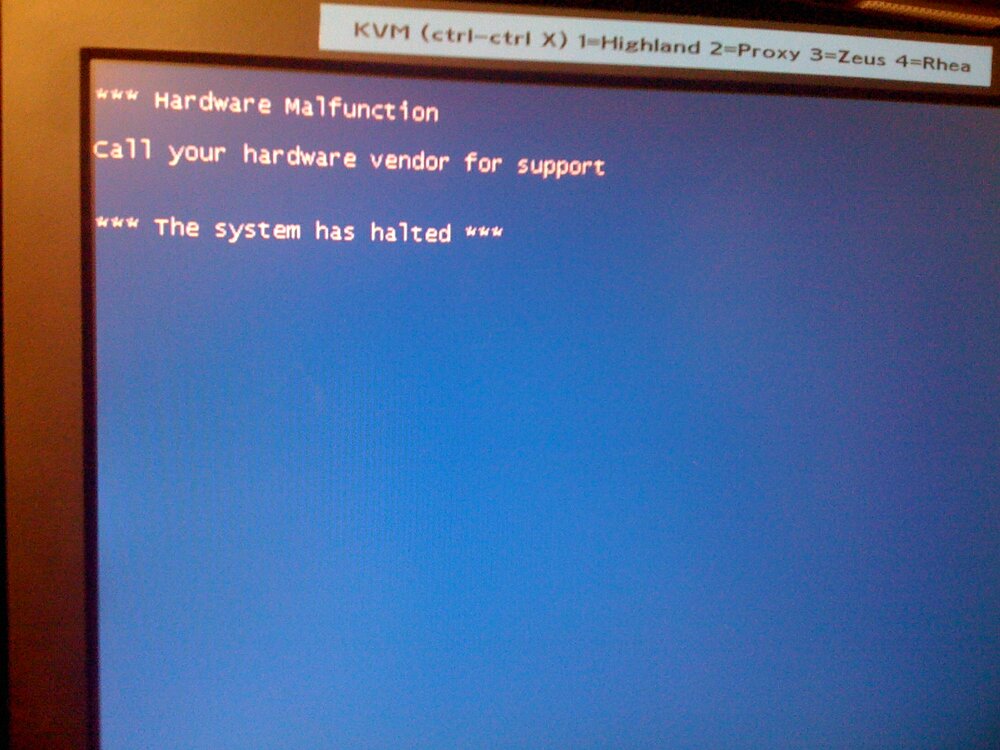

One of the servers is randomly restarting every 20 minutes or so with an unknown hardware fault. We've caught it once on a blue screen saying just that "Hardware fault" (no other info) before ASR kicked in a rebooted the server.

If I turn ASR off then the server just freezes up but no reboot. I end up having to manually reboot the server. Only once have I seen a blue screen for an error which I think may have been thrown up by ASR before it restarted.
