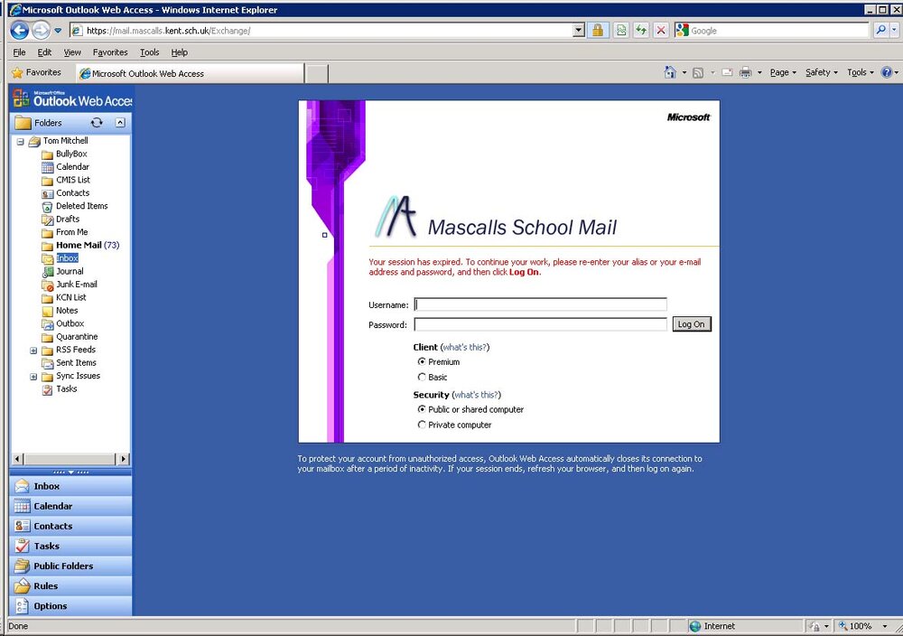

The attached screenshot shows what a user gets when they visit the OWA page, before they even attempt to log in. The mailbox on the right is that of the previous user.

At a guess...
Does the LA reverse proxy to your ISA\OWA server? Or do you have direct internet access?
I'm guess it's proxied, because ISA is seeing all the external connections coming from 1 address, the proxy server.
Again, total guess.
Is in your publishing rule under 'To' 'Requests appear to come from the ISA Server Computer' or 'Requests appear to come from the original client' selected?
My guess is the first option, if so, you could try the second option. This is only possible if the default gateway on your Exchange is pointing to the ISA.
