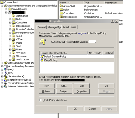

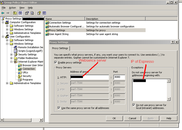

If I understand your problem and it is the same as ours, I places an exception in GPO. We have Websence server for internet filtering. Espresso Equiet Cachepilot had to bypass the filter to allow smooth display of video.

Anyway, the GPO setting for proxy and exceptions is in User Configuration. We have Windows Server 2003 and are running IE 6, so it may be a bit different for you. The setting is in our domain policy, but I guess you can put it where you need it. It is at: User Configuration>Windows Settings>Internet Explorer Maintenance>Connection Proxy Settings.

Thanks for that. Can you post more detail of how you did it please?

Andie gave a very good explanation on setting GPO. Won't hurt giving you my version.

Yours are much better - pictures are always best!!:D I was just struggling because of the awful GCHQ advert, but that's another thread...
