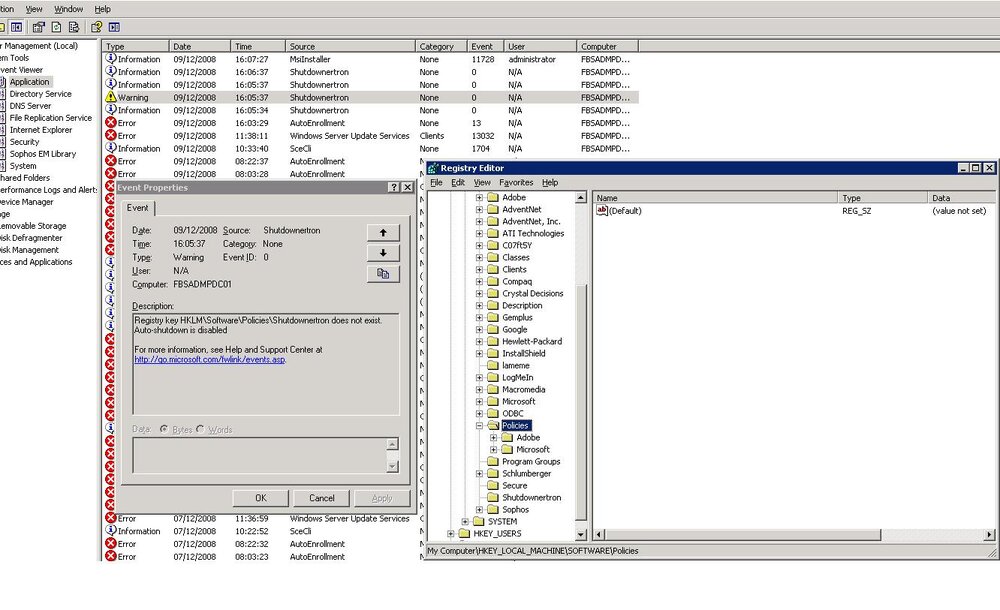

I have installed Shutdownertron on the server and imported the template and configured the settings to shutdown in certain time etc. I applied the GPO to my test machine, but it did not shutdown the PC, I tested the GPO on few different PCs but no joy, when I type gpresult on the client PC it does show that the policy is applied. Please let me know what am I doing wrong and whether there is a more detailed installation manual
When you start the service it logs the current settings to the event log (control panel -> administrative tools -> event viewer -> application log). Can you paste this and any other messages it has left?

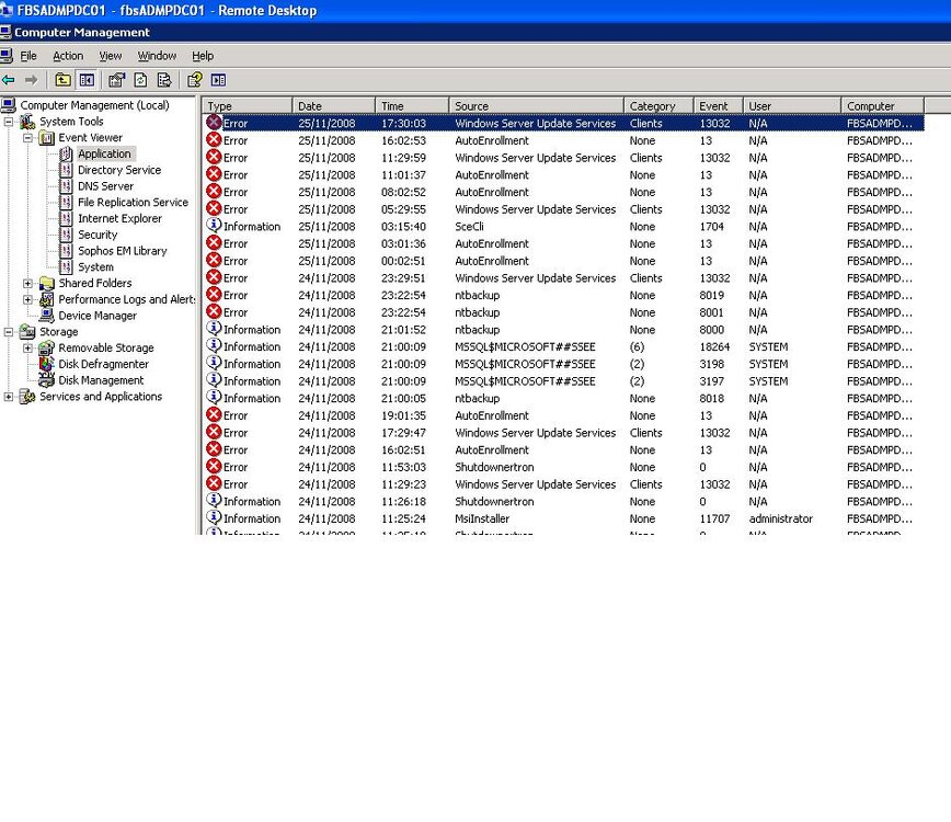

I checked the application log on the server it says:

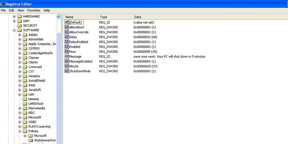

I have reinstalled the new version and applied the policy to my test PC again and when I go to the registry of the test PC all the settings are appliedtest PC.JPG, yet the machine wont shut down
Not even logging its settings as the service starts? in which case the service hasn't started properly, check that it is running as the local system and try starting it manually. If it fails to start check the event log for related Service Control Manager entries, if it does start check for an entry from Shutdownertron to say what it's current settings are.
Edit: looking at your screenshot, there's a shutdownertron error logged at 11:53. This is a guess, but the service hasn't been upgraded and then restarted since you updated the policy template. Going between 1.2 and 1.3 the policy format changes slightly, and if you don't use the 1.3 agent it will crash nastily.
the version installed is 1.3. You can see from the image that there is no entry for Shutdownertron in the registry. but yet my test meachine has the right registry settings applied, posted in my previous post.
Well where your previous screenshot of the registry looked correct, it now isn't - the policy isn't being applied to that machine properly. Fix that (try gpupdating it) and then post some event viewer events.
