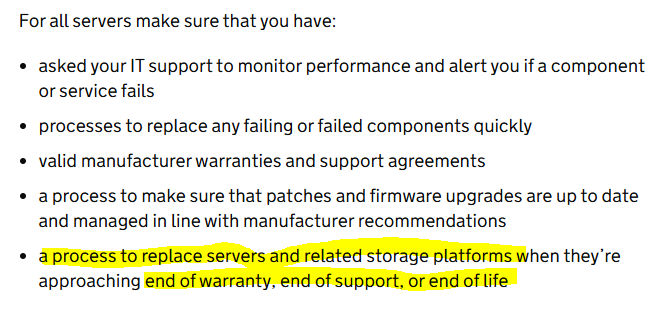

Really appreciate all the points of view. @DrBeaker I knew there was some compliance caveat floating around somewhere that meant we couldn't just do this (officially... 👀😅)
The current equipment doesn't feel or seem slow in anyway, in that we don't feel or notice any bottle necking really. So definitely will raise going with third-party warranty to our govs.
