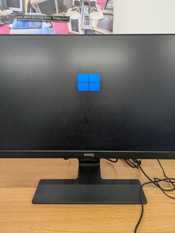

Bit of nightmare here. We had 40 HP mini G9 desktops delivered which were intuned back in june by an external company.  When we plugged them in they had timed out of completed their process so we had to reinstall them all. Not that bad as it gave me time to get my head round the system.
Problem is they randomly hang at boot at the blue windows logo screen. I have tried.

A couple have hung at the wolfguard logo which is why I thought it was a hardware issue.... We had 10 HP laptops delivered at the same time with the same intune policies but they work fine.

Are they definitely booting as UEFI? Check BIOS is set to UEFI only. I have a feeling that windows logo means its legacy - if UEFI you'd get a HP logo and the loading animation... I might be wrong but worth a check!

Room of 20 and 7 still went to the blue logo :(
