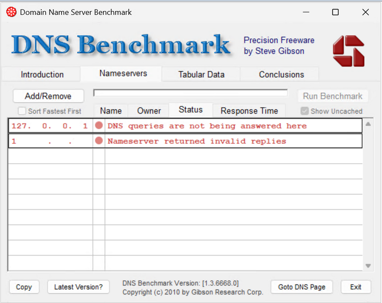

Oh I missed that you could carry on - likewise we have most DNS blocked here. Anyway, still doesn't seem to work though;
Never had this before and have used this in the past successfully! Can't even "Run Benchmark" as greyed out...

Yep I get "The DNS server at this IP address does not provide domain name service answering client queries.  It should not be used for normal client-based resolution"  which is odd because I have the local DNS servers set on this machine at the moment and it is quite obviously working....  I removed all the default leaving on the local system servers.
