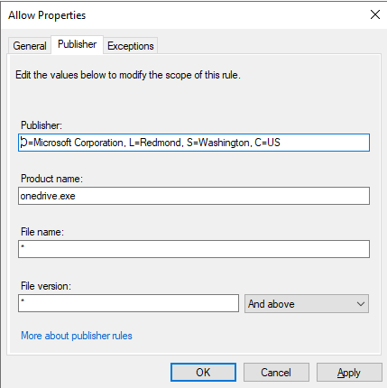

We explicitly allow these executables to run, seems to do the trick for onedrive.
Ideally you need to run in audit mode & collect logs to see what is being blocked.
The one that tripped me up when setting up AppLocker is getting the rules generated automatically adds the version currently installed on the device. For example, if I have Chrome version 138.0.7204.97, then it will pick that as the lowest version to allow. If that's the latest version then any machine that isn't bang up-to-date as of implementing the policy will have that application blocked. I got around this by removing the version (asterisk in the file version field, as pictured above) fixed most of the initial issues I was having.
