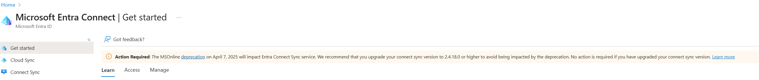

chazzy2501 Posted April 22, 2025 Posted April 22, 2025 I assume everyone has already done this but new users are not syncing for me... So I'll assume I have to update to Entra Sync, cloud sync?... Do I setup the new sync and leave the old one active? I see instructions for setting one up but not migrating from MSOnline.
chazzy2501 Posted April 22, 2025 Author Posted April 22, 2025 I think I need a connect sync, as cloud needs a P1 Licence, so that answers a question..
chazzy2501 Posted April 22, 2025 Author Posted April 22, 2025 ok, I'm using Azure AD Connect... Don't even remember doing that!
chazzy2501 Posted April 22, 2025 Author Posted April 22, 2025 Which says entra connect, so I'm up to date.. I mis-read a powershell plugin warning. now to find the missing user with no errors?!
chazzy2501 Posted April 22, 2025 Author Posted April 22, 2025 nope, action required?!!?!?! A powershell plugin and update the version... I'm confused!
robintech Posted April 22, 2025 Posted April 22, 2025 What version do you have for Entra Connect , should show it on the Status page at the end https://admin.microsoft.com/adminportal/home?Q=entra#/modernonboarding/identitywizard Imagine its the PowerShell that connect uses that is expired https://learn.microsoft.com/en-us/entra/identity/hybrid/connect/reference-connect-version-history#breaking-change-on-entra-connect-sync 1
Olliedawg Posted April 22, 2025 Posted April 22, 2025 Entra Connect Sync requires an update. You do not need any extra licencing to use this. We're on version 2.4.131.0 You should be able to just run the .msi and it will update, no extra config required 1
chazzy2501 Posted April 22, 2025 Author Posted April 22, 2025 ah, where is the new msi for it? my version is too old, so I only need to update the entra connect, no powershell stuff?
Olliedawg Posted April 22, 2025 Posted April 22, 2025 (edited) Its now called "Microsoft Entra Connect", however the desktop shortcut still says "Azure AD Connect"... I'd have a look at this, should all be fine though. Introduction to Microsoft Entra Connect V2 - Microsoft Entra ID | Microsoft Learn This is the download link to the latest .msi Download Microsoft Entra Connect from Official Microsoft Download Center Microsoft keeping it simple as usual! /s edit: you need powershell 5 as a minimum. Edited April 22, 2025 by Olliedawg
chazzy2501 Posted April 22, 2025 Author Posted April 22, 2025 there are versions of powershell? does it update itself!? cheers
Olliedawg Posted April 22, 2025 Posted April 22, 2025 10 minutes ago, chazzy2501 said: there are versions of powershell? does it update itself!? cheers There is indeed! I don't believe it does auto update.. might be wrong though. check version with $psversiontable 1
chazzy2501 Posted April 22, 2025 Author Posted April 22, 2025 ahh 5.1 thanks... is this message generic then and not a specific warning for me?
Olliedawg Posted April 22, 2025 Posted April 22, 2025 I believe that is showing due to the version of connect you are using, i'd get it updated when you can. It's pretty simple just using the .msi
chazzy2501 Posted April 22, 2025 Author Posted April 22, 2025 that is confusing as I am already running 2.4.131.0 (autoupdate must be working as I've not touched it in ages) my missing user is confusing, no sync errors, no user... this message, is or is not related..
Olliedawg Posted April 22, 2025 Posted April 22, 2025 Hmm, can you force a full sync with powershell? Start-AdSyncSyncCycle If you create another user, does that user sync?
robintech Posted April 22, 2025 Posted April 22, 2025 usually happens for me when that OU isn't set to sync in the Entra Connect 1
chazzy2501 Posted April 22, 2025 Author Posted April 22, 2025 12 minutes ago, robintech said: usually happens for me when that OU isn't set to sync in the Entra Connect Yes, I thought this as some AD changes were made but checking the user OUs were untouched.. I have just reconfigured and selected them again just in case... I did also try a full import earlier as well.. no errors, no sign of the user?!?!
chazzy2501 Posted April 22, 2025 Author Posted April 22, 2025 ok, it seems that the Domain Controller it was querying is at fault... 3 good, 1 bad it chooses the bad, so that's a day wasted Now I can worry about how a virtual DC gets screwy without any events?
