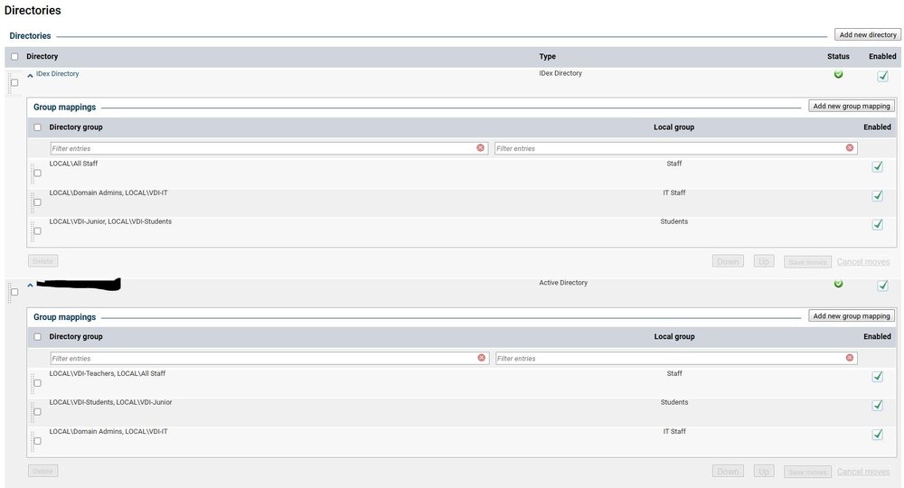

It sounds that user authentication is not setup - take a look at this
Smoothwall Filter & Firewall: Authentication Methods – Help Centre
I am not sure what the best thing to use is for local AD now, as we use the cloud filter module - but IDEX is probably what you are going to want
The normal setup is to install the Smoothwall iDex client on a DC, then enable iDex on the Smoothwall. That should then show the AD user on the Smoothwall logs instead of just the IP.
Should. It doesn't always work, but it's okay (you can cross-check easily enough against other logs to that IP).
It seems like something has been partially set up, as Smoothwall is connected to Active Directory and is filtering based on the groups students belong to.
