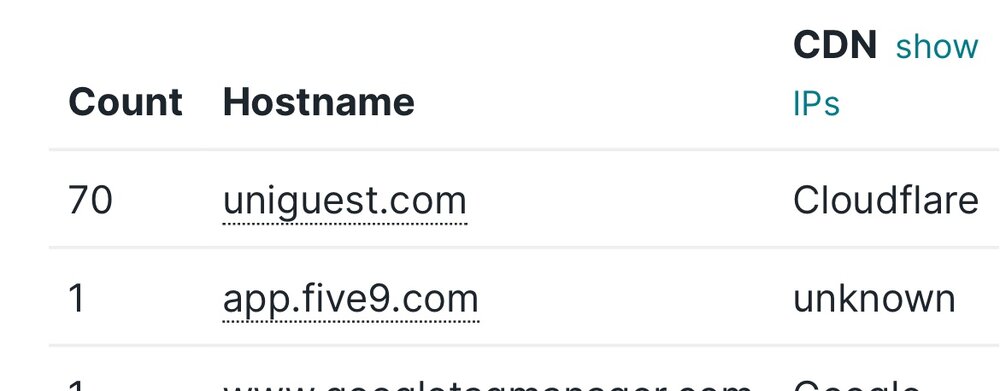

Have you tried whitelisting their Cdn also
I am finding the following Cdn
[ATTACH]71779[/ATTACH]
Tried this and it hasn't changed anything.
