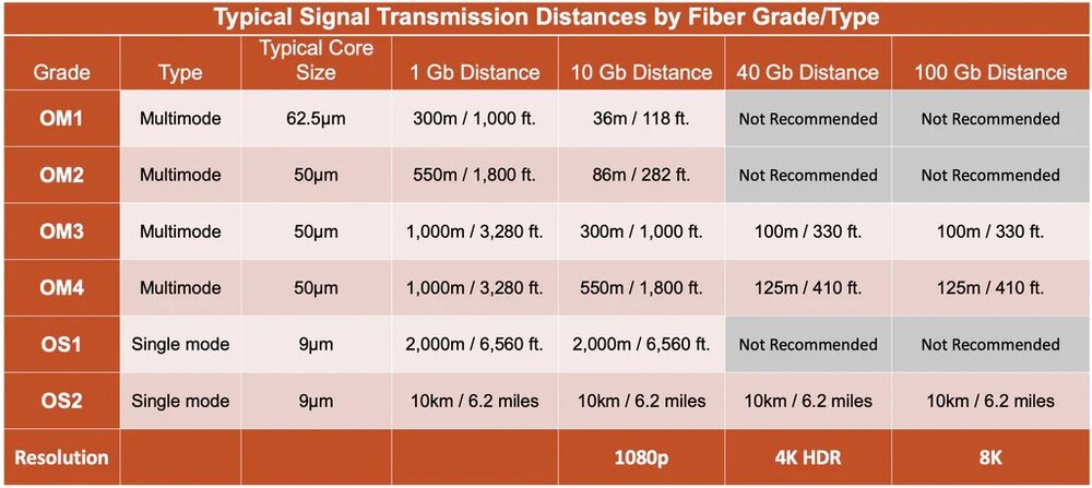

Do not go multi mode OM4 - go Single Mode OS2.
Why?
  • The main reason is Single Mode is much more future proof, it can carry fast speeds at longer distances. You won't need to upgrade as much.
  • If you want, you can use Bi Directional SFP. This means you only need 1 strand of fibre not 2. Effectively doubling the capacity of the cable.
  • You can also use it to patch through incoming telco fibre - should you need to.
  • Single Mode used to be more expensive than multi mode. But with lots of fibre to the home installations it's made it much cheaper. A recent install at work, it was cheaper!
One big thing to note, if your cable runs are over 125 meters and you want to go above 10gig in the future that OM4 cable will be no good. It will be maxed out the day it is installed.
Why?
[ATTACH=CONFIG]71750[/ATTACH]
I was going to recommend single mode fibre, although as the DFE guidelines above recommend a minimum of OM4 you can have problems explaining that OS2 is better.
I would not replace the Cat5e unless it is causing an issue, it can run 10Gbps up to 45m and 1Gbps for 100m per the spec so for end user devices this should be plenty for the next few years.
I would strongly recommend that you get a data cabling company to do the install not an electrician and make sure you get a full test report on the install to British Standards 50173.
Never even thought about single mode, as I just had Dfe standards and OM4 in my head.
I think this is a major oversight by the DFE. Repeating what I said above, OM4 is very likely to be maxed out on the day it’s installed. There will be lots of installs that exceed 125 meters.
