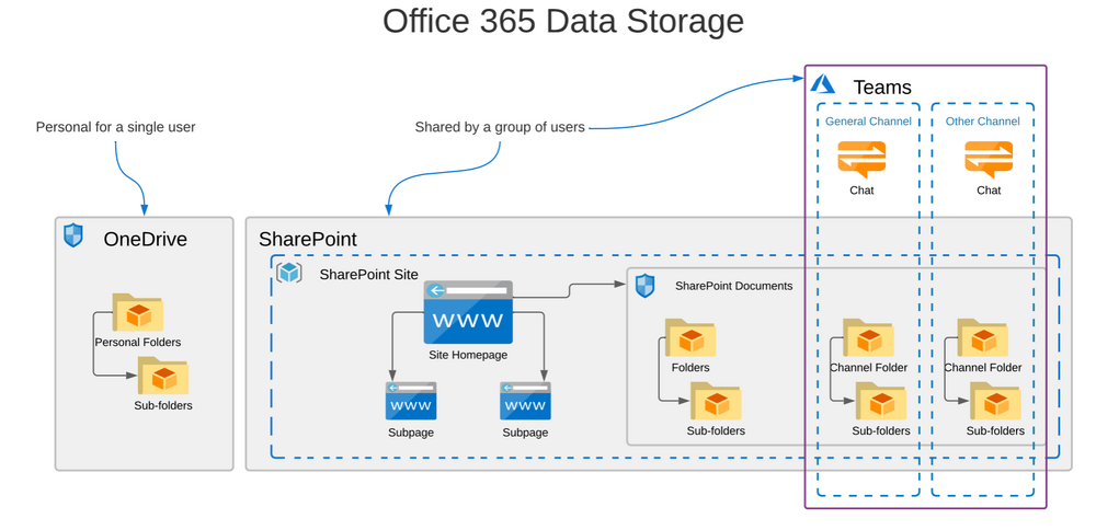

Yeah. We've got a "All Staff Shared" SharePoint/Team for all whole school stuff, Department/Curriculum Area SharePoint sites/Teams for department shared work and teaching resources, and OneDrive for personal stuff like CPD/Appraisal.
Training wise, we started from a point of "SharePoint=Old Shared Area" and "OneDrive=Old Home Drives" but in the cloud, referencing back to things they already know like an on-site shared drive helps (the phrase "like the old shared area" appear a lot in our training docs). The below graphic helped staff get their heads around the idea that Teams Files tab and SharePoint are the same place.

Love that diagram, did you make that in house? If so what tools did you use? I'd love to see/make a tweaked versions to cover the Assignments Module/Student Work Doc libraries
