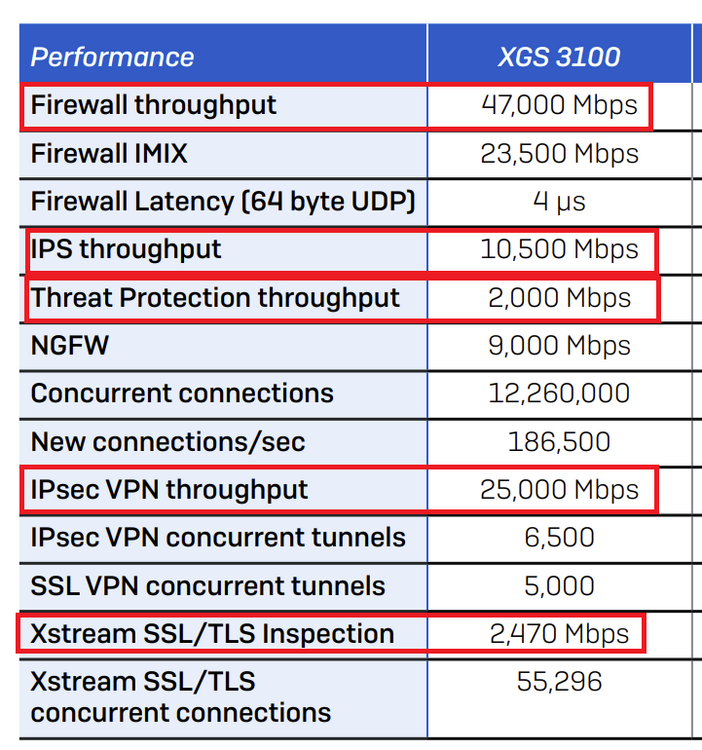

Generally most the firewalls change the throughput depending on what you're doing with it. Obviously it's a very different scenario if you're only doing firewall vs ips/threat detection/decryption etc.
For example (With a Sophos XGS):
Was there a specific type of throughput you're referring to in regards to the S15? As obviously the 10Gbps comment could be two different numbers referenced if you're referring to firewall only, and they're referring to threat protection etc
Steve
