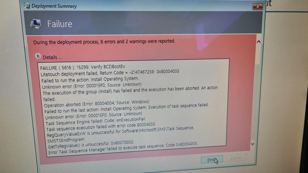

Today have restored the image to a bare metal machine, and got the error below.
I then created a new image on a physical PC, captured it , restored it, but then got the same error.
please could anyone advise/assist why capture/restore on VM works, but capture, restore or restore of any image to physical hardware fails with the above error in photo?
thanks.
Just an update - I have restored the physical machine captured image back to the Hyper-V VM and that's restored absolutely fine, so appears to be an issue restoring any image to a physical machine.

That is a known error with MDT and the ADK version when used with BIOS devices.
https://support.microsoft.com/en-us/topic/windows-10-deployments-fail-with-microsoft-deployment-toolkit-on-computers-with-bios-type-firmware-70557b0b-6be3-81d2-556f-b313e29e2cb7

If it is a newer machine then may be worth resetting the BIOS to factory settings to ensure stuff like SecureBoot hasn’t been disabled in the past

There’s a fix for that something like running a script part way through the task and had it myself with MDT. I’ll dig it out tomorrow.
This is windows 11 and EUFI BIOS

What ADK version you using?
ADK - 10.1.22621.1
ADK Windows PE 10.1.19041.1
both are versions for windows 11 22H2 and thats the version i'm deploying/capturing.
May not be relevant with the fix @snagrat posted but I'm using the same version of MDT I started using with win10 and I added the script when I got the same error. I've left the script in place and it still works with win11.
It's an old video but it works.
