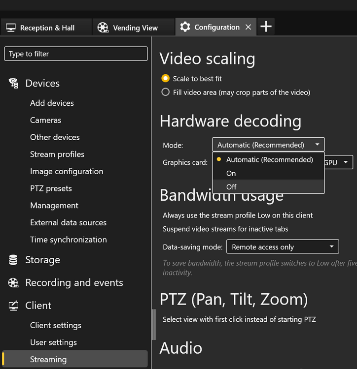

RobFuller Posted July 17, 2025 Report Posted July 17, 2025 We encountered a similar issue where the client application would crash under certain conditions. After some investigation, we discovered that disabling hardware decoding resolved the problem. Interestingly, the issue never occurred on the server side, likely because we were connected via RDP.
