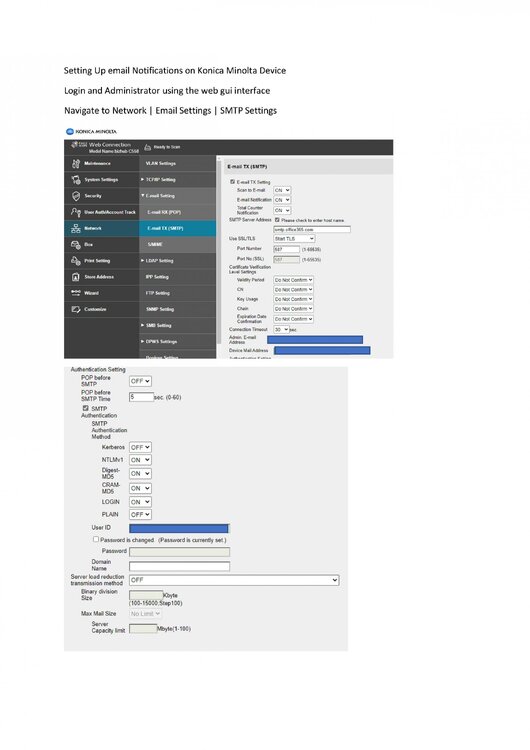

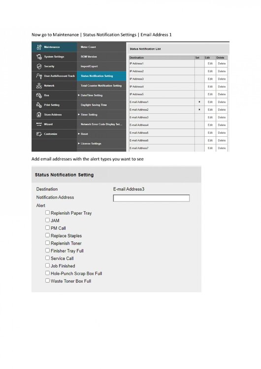

If you not managed to work it out already. I have this setup on one of my schools. I admit when setting it up Konica back gui is not intuitive by any means and took me a while. I will put together a little crib sheet for you when I can this week.

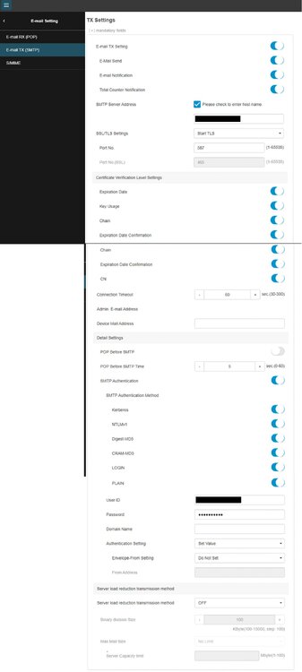

[ATTACH=CONFIG]68828[/ATTACH]
[ATTACH=CONFIG]68829[/ATTACH]
Thanks for the screen shots, though i've already got everything set that you have set.
