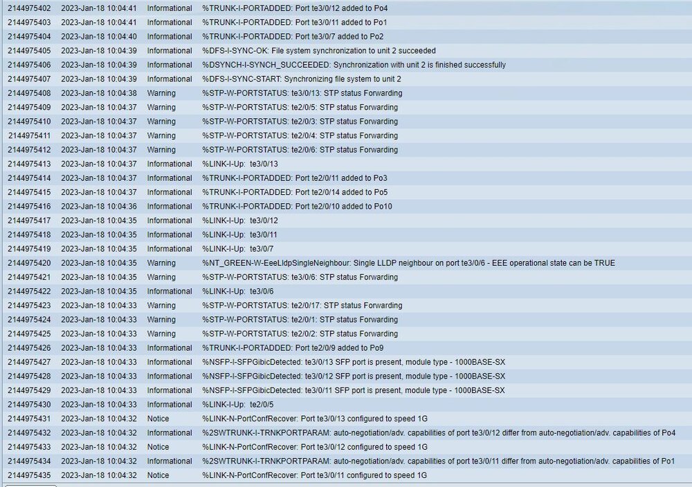

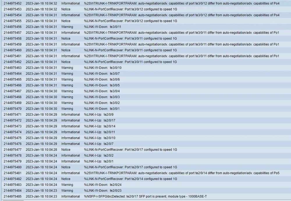

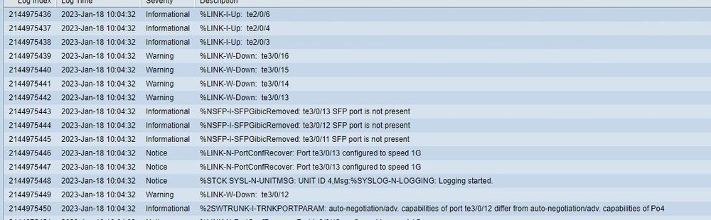

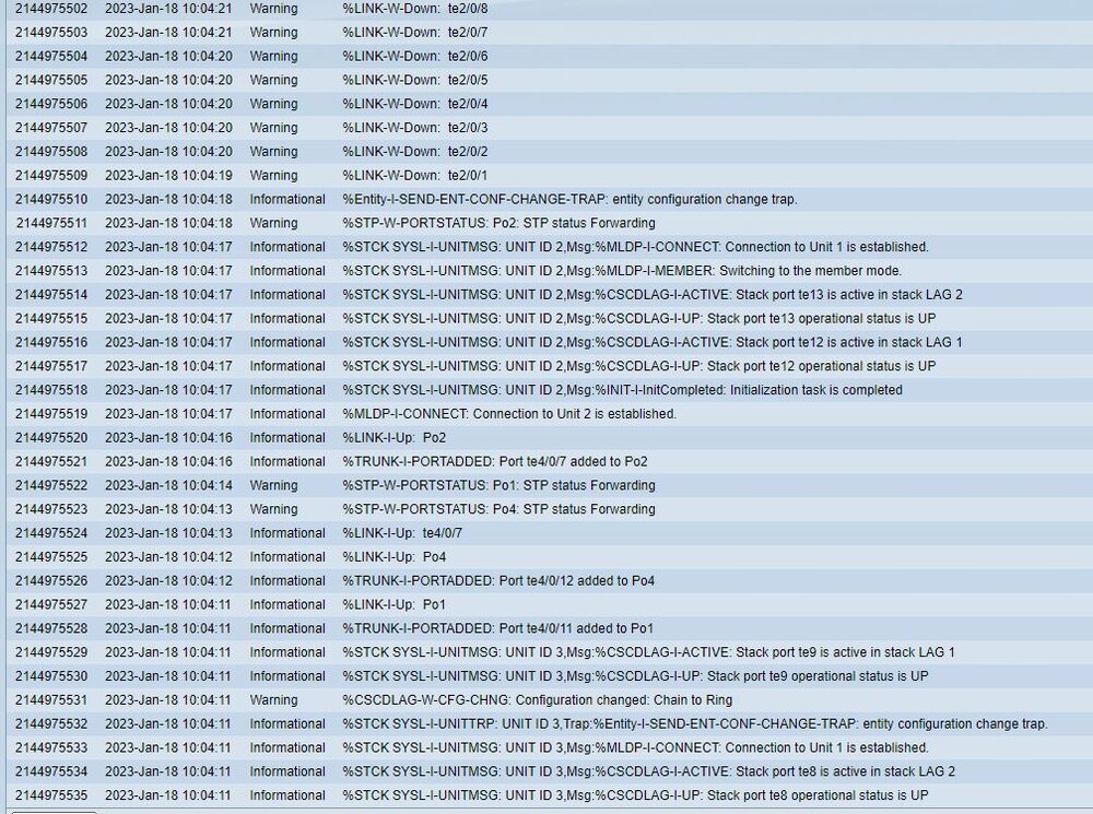

Firstly, logs have this repeating loads:

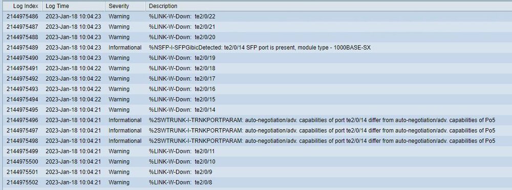

Next, this blip appears just the one time I noticed:

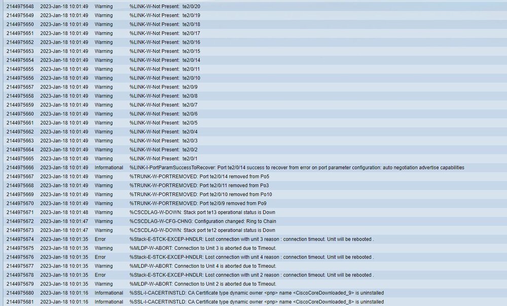

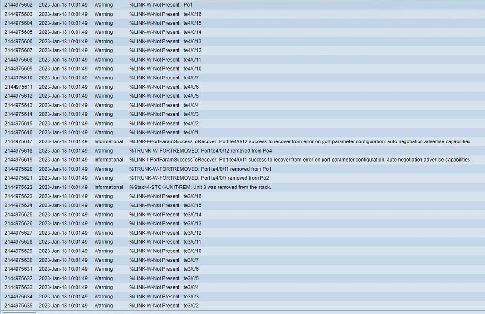

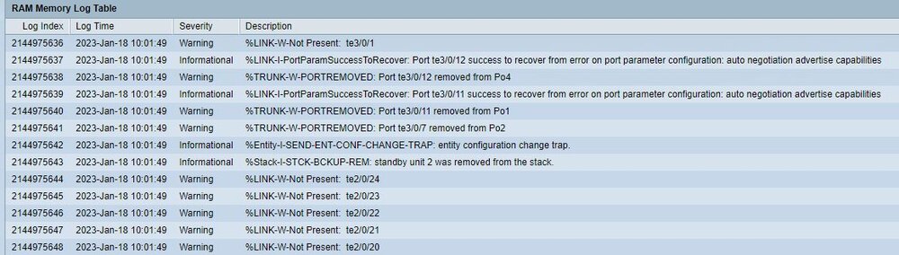

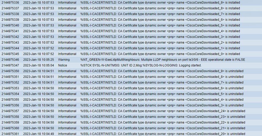

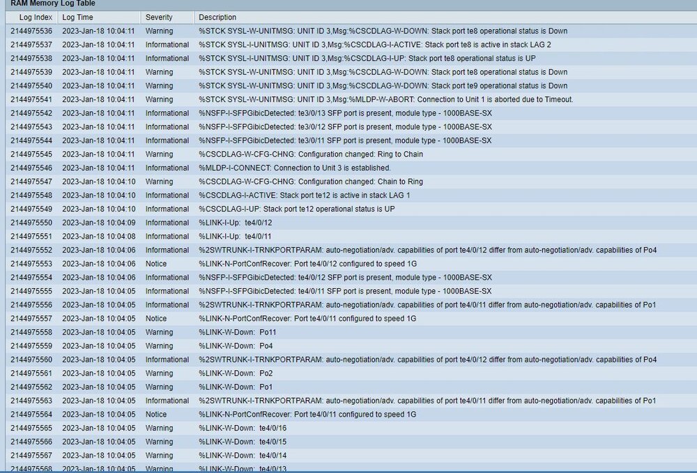

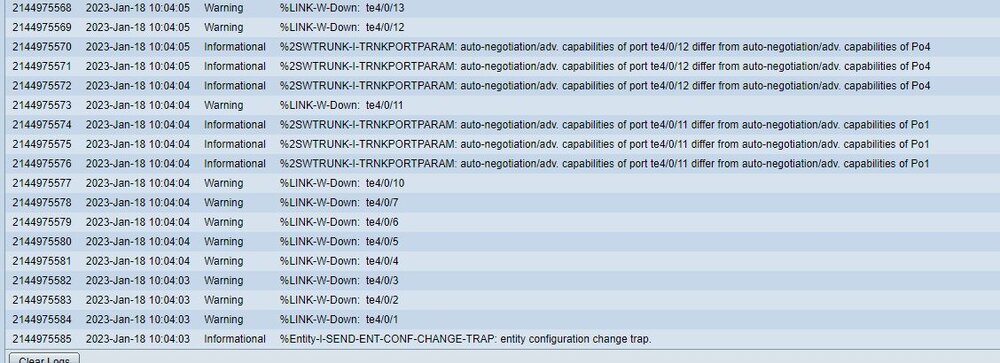

A full-on crash (amidst the SSL cert howling on it) looks like this (lots and lots of pics of this one:)
From dashing to the server room it does look for all the world like switch #2 in the stack is flapping somehow, but I'm not seeing at the moment what those logs are trying to show me.
If anyone who is a whizz with Cisco gear is looking and it's really obvious please do let me know! If I crack it in the meantime I'll post up what fixes it. Really has me stumped for now though.

I haven't looked at all the logs as for whatever reason I am struggling to open the images, but it looks like something is going wrong with the stacking.
What model switches do you have and how are they stacked? You said they are split across 2 buildings, so I am guessing you're stacking using VSS? If so I guess this is going over fibre optic?
Are you able to run "Show Switch Detail" and "Show Version" in the CLI please and post the result here (or via PM) please?

Ok hopefully these pictures come out. Cisco SX550X switches, switches 1 and 2 in the server room, switches 3 and 4 in another building. All over fibre but not sure what VSS is tbh.
Snips of all those bits here:
Interesting #2 switch says it's on "standby".

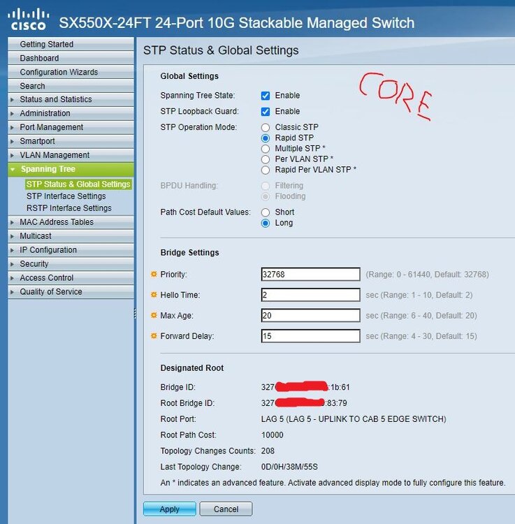

Looking at the spanning tree config on the core stack, I see this:
Now, my knowledge of the guts of spanning tree isn't amazing, but I should imagine (and please do steer me right if I'm not right) that I should INSTEAD be seeing the root bridge ID as being the bridge ID here (as in the "boss" route for spanning tree should be the links twixt the four switches in the stack which make up my core switch here.) And also, that priority for the "boss" bridge should be 0. Or lower than default at any rate.
So, what the heck is that odd bridge ID? Well it's this:
Looks like one of the edge switches in an out-building we have has the LAG connection (going to switches #1 and #2 of the core stack) with the root bridge ID! And by my reading of it, port TE2/0/14 is a major culprit in the flap logs, which plugs into my favourite suspect in this, being switch #2 of the core stack (the other being in port 14 of core switch #1.)
A couple more edge switches to rub it in:
That looks to be worth re-working. As I mention not super with Cisco gear so if anyone passing can check my thinking that'd be great.
Normally we'd set the core to have the lowest bridge ID, I usually set to 8192.
That said even with them all at the same priority, the root will be elected based on MAC address / Switch age.
Setting the cores bridge ID lower would probably be a good start.
With all that said we've had a lot of issues over the years with this series of switches and instability, can't believe Cisco ever put their name to them.
Cheers for that, from what I'm digging up setting that priority lower looks indeed to be the way (I take it you mean set the priority lower, not the bridge ID.) No idea how I knock off the root port yet but will be one to try as part of all this.
Haha deep joy, my network here comprises these Cisco small business switches.
Yep, sorry priority lower
