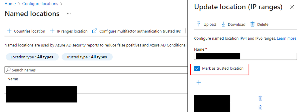

Staff MFA enabled for "Any Location" with "Trusted locations excluded".
Make sure you set your named location (of internal IPs) as 'trusted'.
Screenshots attached.
