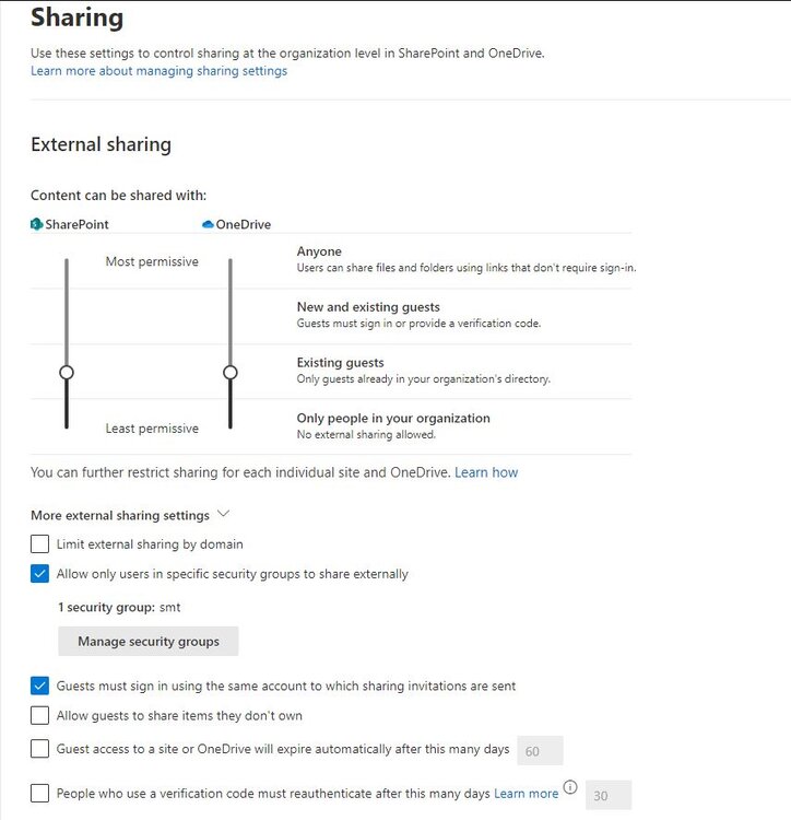

I'm trying to allow a member of SMT to share a document with the headteacher of another school.
Setup is:
I've checked our SMT member is in the security group allowed to share externally.
I've checked the external headteacher appears in our admin centre as a guest.
What am I missing as the sharer is getting this error?

We have more limited sharing than shown in your first post (the Limit by Domain is enabled for us) and, for the most part, it works, so I feel like it will be something daft.
