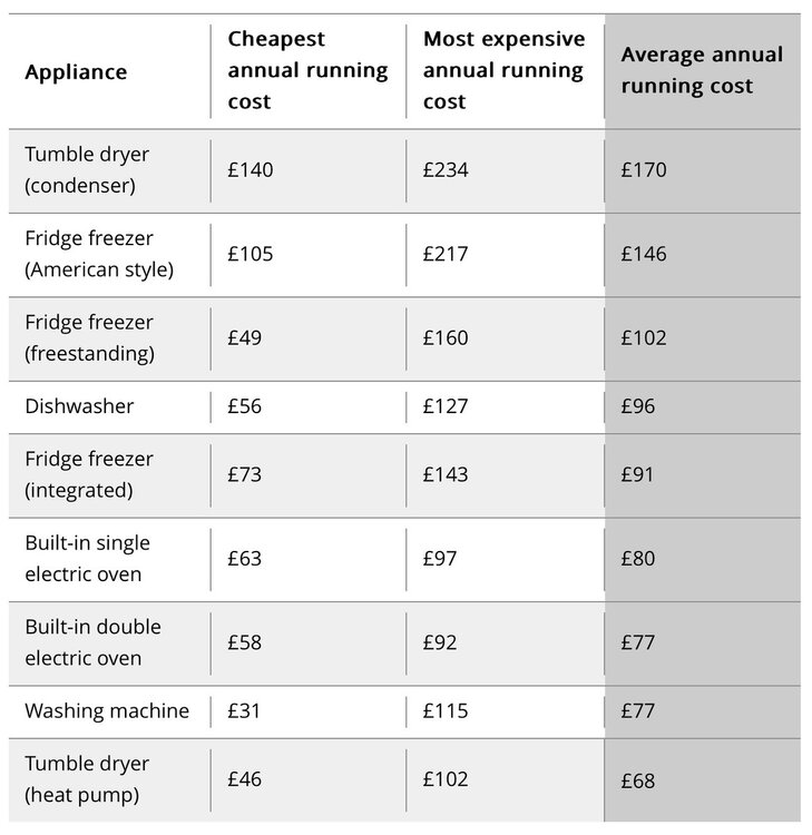

elsiegee40 Posted November 27, 2022 Posted November 27, 2022 (edited) What's the advantage over condensed dryers; is it more efficient? Yes according to Which magazine Source https://www.which.co.uk/news/article/find-out-how-much-your-household-appliances-cost-to-run-aP1BZ7f2GNYd Edited November 27, 2022 by elsiegee40 1
Cw2k Posted November 27, 2022 Posted November 27, 2022 What's the advantage over condensed dryers; is it more efficient? Significantly cheaper to run. Run as a lower heat so less aggressive on clothes. Only downsides are more expensive upfront and drying cycle is longer.

Ditto Posted November 28, 2022 Posted November 28, 2022 I've had it for a 3 years now but when I purchased mine all of the Samsung dryers had a manual water collector. From a quick scan, compared to a condenser, payback should be 2-3 years based on Which figures, so you should be saving from now. My condenser (Bosch) has a manual water collector, but has the option of an adapter kit to plug into waste. I've never bothered. Good source of distilled water if you need it!
