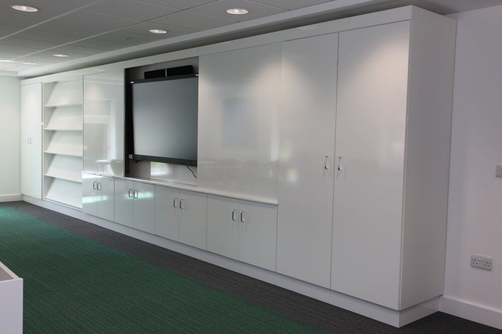

Define a teaching wall, with educational rationale rather than "it looks nice" and with some clear guidelines on who will be creating the content to go on such a high-resolution device.
Here pixel pitch has a direct correlation on how far away the closest viewer should be - for every 1mm of pitch the viewer should be 1m away. (ie 2.5mm pixel pitch, closest viewer should be 2.5m away. Try fitting that into a classroom!)
Possible, but it aint cheap and I would argue not suitable for a normal classroom setting - a random bag being knocked into it could be quite pricey to replace! All that said have a look at https://displaysolutions.samsung.com/the-wall - this looks promising.
