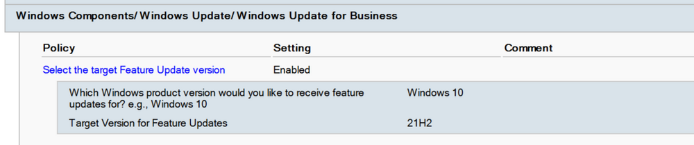

You need this policy set if you dont already. If you dont specify Windows 10 then users will be prompted to upgrade.

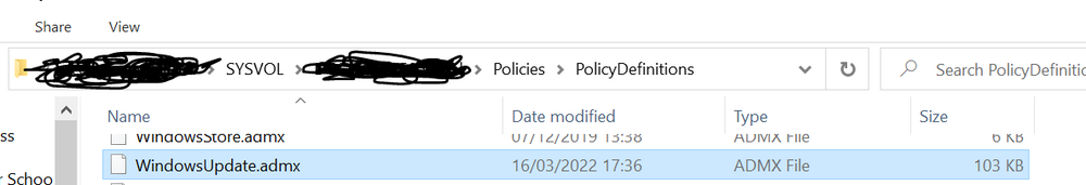

I don't have this option?! I assume I need some new ADMX files for the policy store, what ADMX files do I need?
Make sure you have the latest admx files https://www.microsoft.com/en-us/download/details.aspx?id=104042
Install locally and copy to your centralstore https://docs.microsoft.com/en-us/archive/blogs/canitpro/step-by-step-managing-windows-10-with-administrative-templates
Edit your WU gpo, Select The Target Feature Update Version, put in Windows 10 and 21H2 https://docs.microsoft.com/en-us/windows/release-health/supported-versions-windows-client

I've done the ADMX update but the policy isn't appearing, it is under the Windows Update for Business, will this work?

How are the devices configured to update? If they update through WSUS or WUfB they shouldn't offer Windows 11 until you set the feature target to Windows 11, as far as I'm aware not setting it at all does not mean that Win 11 will appear.
If the updates are just direct from Windows Update, no management besides the GPOs setting client side settings, then Win 11 will appear when it's ready.

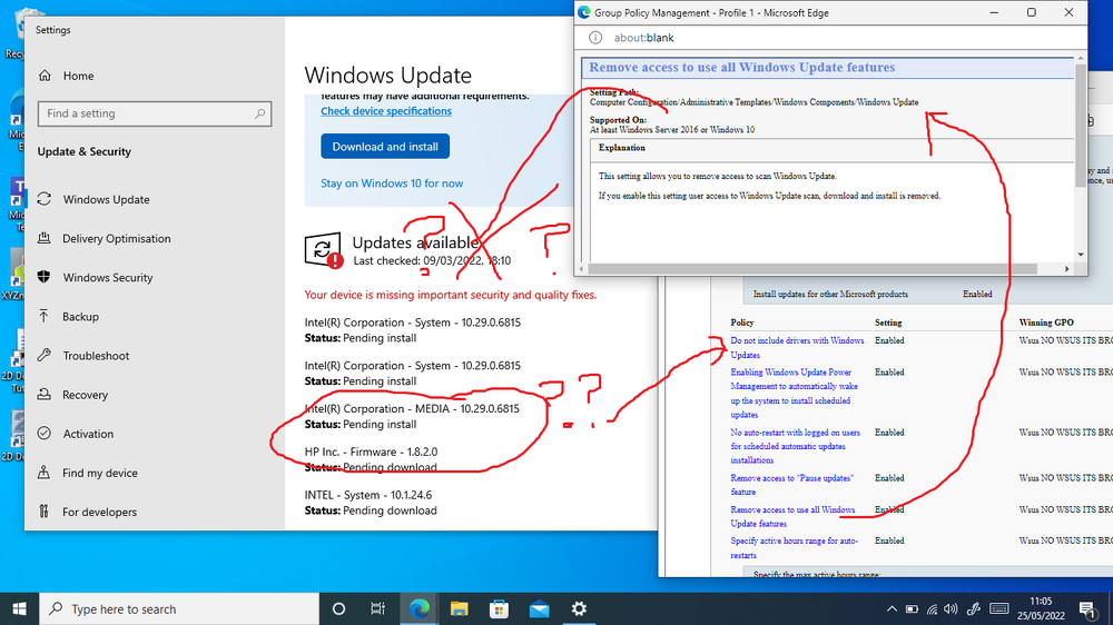

alright screenshot time, I've run a gp result on a staff laptop as a member of staff and the GPO says no but the laptop says yes!
So can I not read and comprehend English?
screen shot, with annoy scribbles included![ATTACH=CONFIG]65578[/ATTACH]
The highlighted GPO doesn't stop updates, just removes the button to allow users to manually run a check (which is absent in your screenshot)
Since you have a GPO called "Wsus NO WSUS ITS BRO...", I suspect that your WSUS is broken. If you can fix or redo WSUS, I reckon that'll resolve your issues regarding Windows 11 upgrades.
Also, the WSUS settings are located in: Computer Configuration > Policies > Administrative Templates > Windows Components > Windows Updates > Manage updated offered from Windows Server Update Service. If you specify a WSUS location in "Specify intranet Microsoft update service location" (even if the source you enter doesn't exist, such as "serverdoesntexist.fqdn") and also set "Do not connect to any Windows Update Internet locations" to "Enabled", that should prevent your devices connecting to the Internet for updates...then the clients shouldn't be allowed to talk to the Internet.
