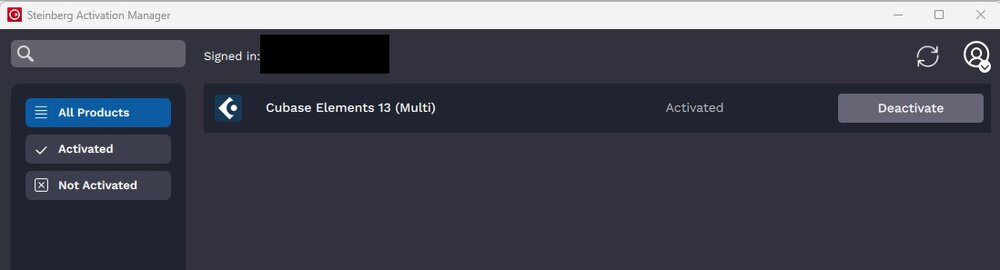

Hello, if anyone still monitors this thread...
I have a license with Cubase 13 license with 'Multi' listed after it, I open Cubase signed in as IT and it licenses (I use this IT account for Steinberg activation manger, downloads etc) but then I sign in as a student and it asks to create an account. Anyone got this working?
we had tremendous problems with the software when bought it a while back especially the licensing, back and forth with their slow support! it was installed on a networked machine and had to create a special account for them to use which had the license activated on as anyone else logging on couldn't use the software as saying unlicensed!
Just to update but after over a year of trial and error with this eventually we decided to Virtualise this software using a VirtualBox VM with local restrictions on it, its not ideal but works much more smoothly as it seems the software doesn't play nice with UAC and requires access to local folders ( it does still ask regularly for activation but this only takes a minute per session so its a sacrifice the department are willing to make) its also worth noting that this is deployed on a relatively small number of machine so its likely not the best solution for IT suites of 30+ computers but if anyone wants some advice on setting it up this way please let me know

This is so annoying. Just deployed Cubase 13 and noticed the 'all user' issue in a classroom setting - fine for the user registering but then the next user sees the unlicenced message
Run the 'enable_current_licenses_for_all_users.ps1' which I thought would resolve my issue but that's not fixed it and even though I can see the activation files moving to ProgramData, i still see the not licensed message.
Also tried the fix from @MCrawford above and thought 'aha, that's an obvious solution, good work' but it also fails. I see the files copy but then nothing :(
Anyone else got this working recently? Not sure if something else changed in Cubase 13. I hate this software - bring back the USB licensing (such an odd thing to say but it worked!)
