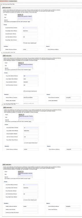

That's what we do, yes. In the GCDS config, the groups search rule is just looking at the AD OU containing the groups we want synced to Google. All our other AD groups are going to be outside of that scope.
If you have existing Google Groups that you don't want GCDS interfering with (i.e. you want to keep them, continue to manually manage them on Google and not sync them from AD at all), then you can specifiy exclusion rules for those in GCDS under 'Google Domain Configuration -> Exclusion Rules'. GCDS will delete any Google groups that aren't matched from AD and aren't covered by such an exclusion rule.

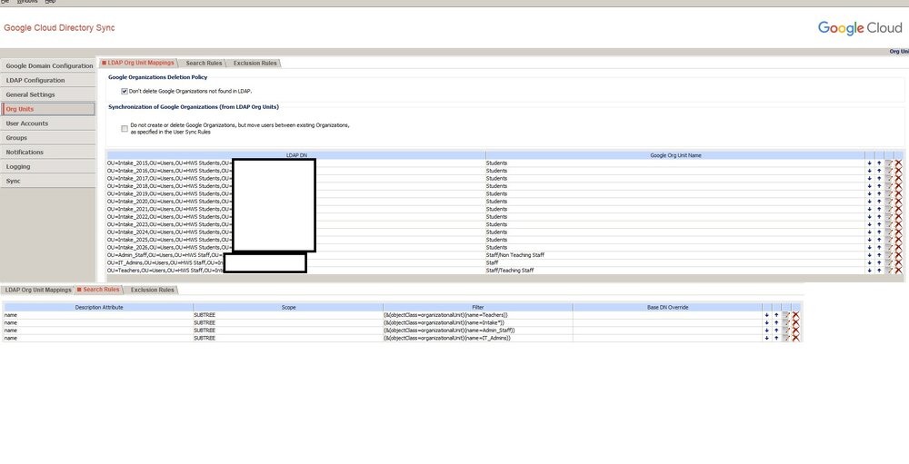

I think I have made some headway.. my team have added some search rules and filters I'll post here, any feedback welcome or if it helps someone with our setup, even better.
Reminder that my existing Google suite is a mish mash of uploaded CSV, and part Wonde sync historically.
So first of all, we looked at Organization Unit mapping from AD - to Google, moving staff from OUs in AD to existing OU manually created in Google..then search rules applied where OUs had a certain OU name, where we want the users synced:

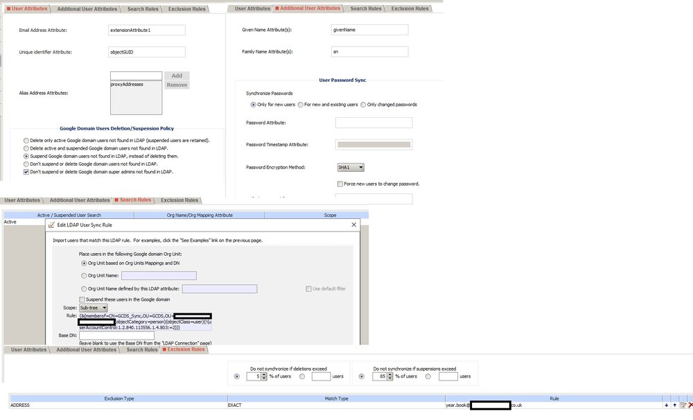

Then we used an 'extensionAttribute1' set up by Salamander to map any manually misnamed accounts on Google to the correct user in AD, Search rule was anybody in AD that belongs to group GCDS_Sync will be Synced, and any odd users that I have to explicitly exclude in exclusion section for odd reasons I cant sync.

In your Org Unit search rules, you've got on that searching for name=Intake*. Since "sch/hinchleyw/InterJigsaw/HWS Students/Users/Student_Leavers/Leavers_to_2019/Student_Leavers/Intake_2013" is matching that pattern, GCDS will be creating the OU structure shown there, which is why it's creating student leavers OUs for you.
