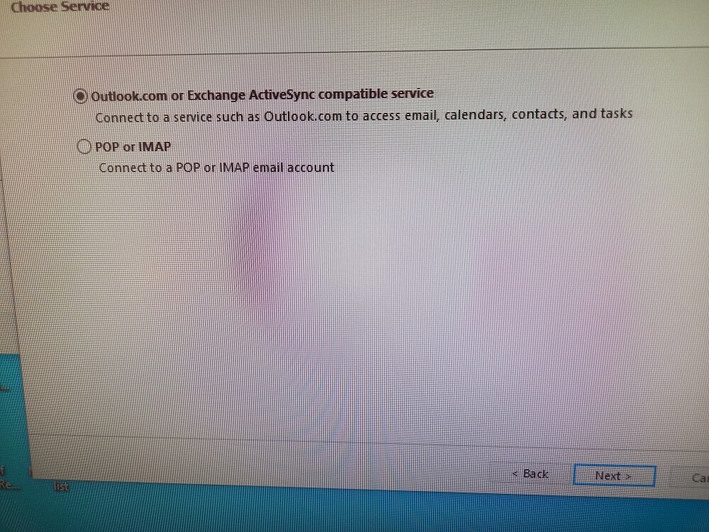

However, in our instance we are not getting the 'more settings' box as shown below in this image :-
[ATTACH=CONFIG]64270[/ATTACH]
We just get the following :-
[ATTACH=CONFIG]64271[/ATTACH]
