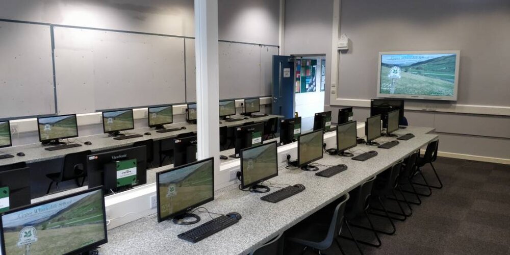

We used 3 compartment dado back to back on some white trimmed wood for our middle run in an IT room. Much cheaper than a 'official' power pole and meant we could use a T to spread out to the desking. I'll see if I can find a picture.
This shows it abit. Neat and tidy and no special hard to find and expensive parts required. Plenty of cable room too.IMG_20180824_155505.jpg
This shows it abit. Neat and tidy and no special hard to find and expensive parts required. Plenty of cable room too.[ATTACH]63066[/ATTACH]
Nice looking layout.
