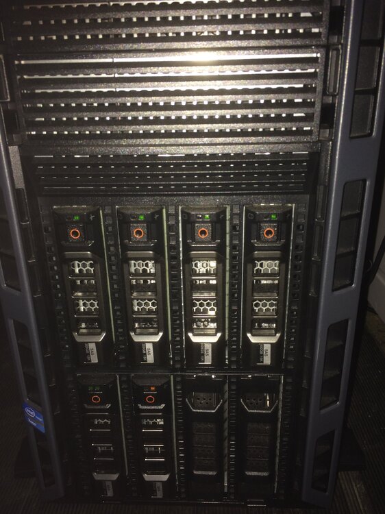

Koldov Posted September 1, 2021 Author Posted September 1, 2021 Not 'lid off' as such, but removing the front cover gives me this view... I think they are in caddies?

Davit2005 Posted September 1, 2021 Posted September 1, 2021 Not 'lid off' as such, but removing the front cover gives me this view... [ATTACH=CONFIG]62940[/ATTACH] I think they are in caddies? Yes those are Caddies, push the red button on the caddies and will release the handle on the caddie to be able to pull the drives out. I'm pretty sure those are Hot-Swap normally on those Dells you only need to power down to add a virtual disk i.e. new raid disk group etc. https://i.dell.com/sites/csdocuments/Shared-Content_data-Sheets_Documents/en/uk/Dell_PowerEdge_T420_Spec_Sheet.pdf 1
