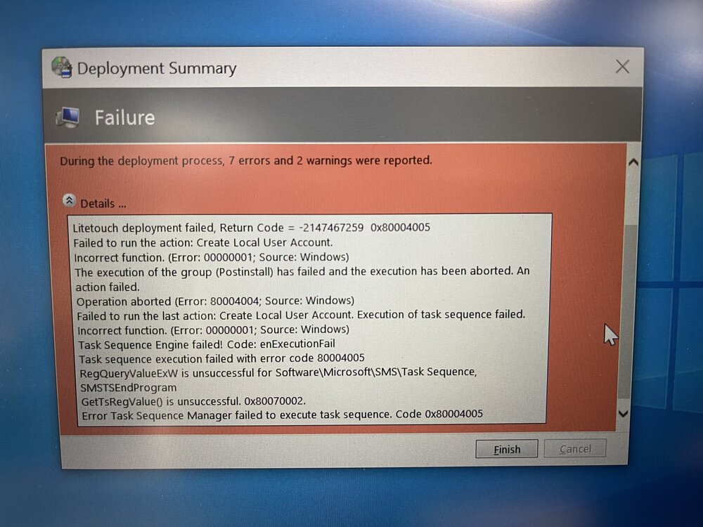

Works perfectly on PowerShell, I have added it as a command prompt Task Sequence for our 1909 build on MDT. I am now getting the following:
It works perfectly on a W10 system when I run Powershell. Really not understanding why this is so difficult to achieve.
I added the Task Sequence at the end of Postinstall named it Create Local User Account, Run command line and it runs: powerhsell.exe New-LocalUser "LocalUser" -NoPassword -FullName "Local User Account" -Description "Local User Account" -AccountNeverExpires.
[ATTACH=CONFIG]62696[/ATTACH]
Did you copy and paste that? You misspelled powershell
Well spotted, but no, I typed manually as server is on another computer so can't copy and paste. It is spelt correctly on server and running like a dream if I do it as administrator on PowerShell by copying and pasting.
